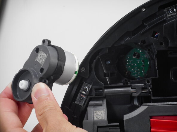

  5. Roborock Q5 Max Plus Side Brush Motor Replacement, Side Brush Motor: crwdns2935265:05crwdnd2935265:01crwdnd2935265:01crwdne2935265:0
    • Use a Phillips #1 screwdriver to remove the five screws that secure the side brush motor.
  6. Roborock Q5 Max Plus Side Brush Motor Replacement: crwdns2935265:06crwdnd2935265:01crwdnd2935265:02crwdne2935265:0 Roborock Q5 Max Plus Side Brush Motor Replacement: crwdns2935265:06crwdnd2935265:02crwdnd2935265:02crwdne2935265:0
    • Carefully remove the side brush motor from its housing.
