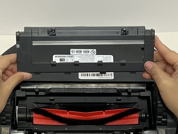

    • Gently lift off the bottom panel cover.
    • If the bottom panel is stuck, use a plastic spudger along the edges to gently lift it out of place, then remove it by hand.

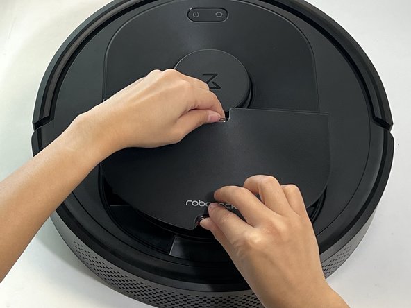

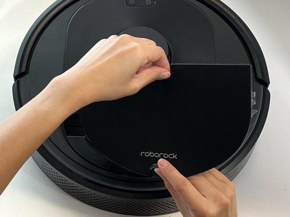

    • Carefully flip the device and place it wheels down.
    • Pinch the dustbin tabs and pull up on the dustbin to remove it.

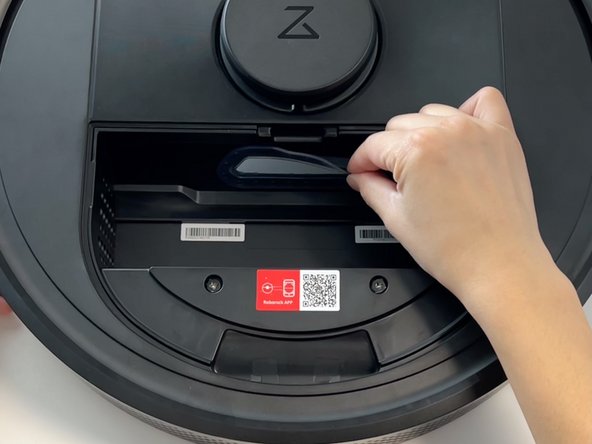

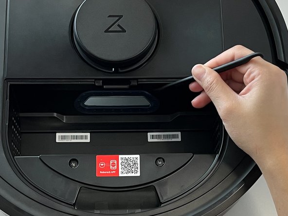

    • Pull the plastic grommet off of the dust port.
    • If needed, use a spudger to help get underneath the lip.

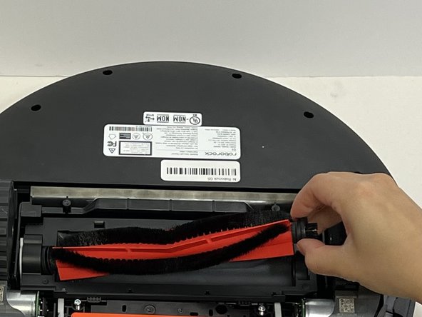

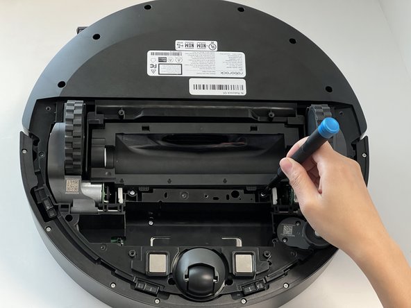

    • Carefully flip the device over and place it with the wheels up.
    • Push both of the gray retaining tabs toward each other and lift the cover on the main brush holder to remove it.
    • Grip and remove the main brush.
  11. Roborock Q5 Main Brush Housing Replacement: crwdns2935265:011crwdnd2935265:01crwdnd2935265:02crwdne2935265:0 Roborock Q5 Main Brush Housing Replacement: crwdns2935265:011crwdnd2935265:02crwdnd2935265:02crwdne2935265:0
    • Use a Phillips screwdriver to remove the two 15 mm screws from the main brush housing.
  12. Roborock Q5 Main Brush Housing Replacement: crwdns2935265:012crwdnd2935265:01crwdnd2935265:02crwdne2935265:0 Roborock Q5 Main Brush Housing Replacement: crwdns2935265:012crwdnd2935265:02crwdnd2935265:02crwdne2935265:0

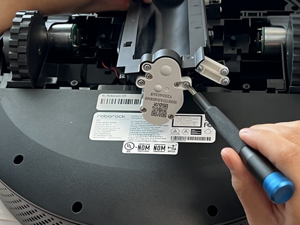

    • Use a Phillips screwdriver to remove the three 15 mm screws that secure the main brush motor.

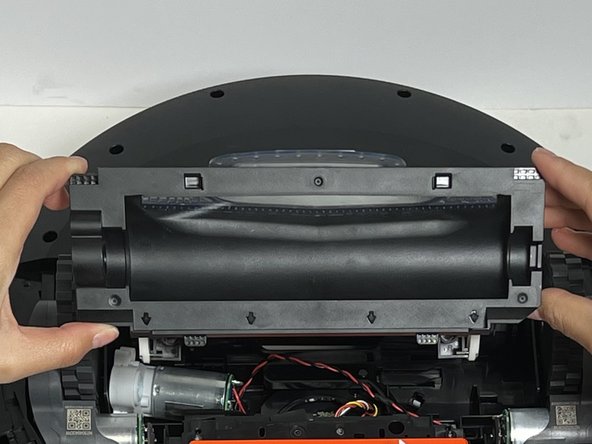

  13. Roborock Q5 Main Brush Housing Replacement: crwdns2935265:013crwdnd2935265:01crwdnd2935265:02crwdne2935265:0 Roborock Q5 Main Brush Housing Replacement: crwdns2935265:013crwdnd2935265:02crwdnd2935265:02crwdne2935265:0
    • Remove the motor from its housing and lift the main brush housing out of the vacuum.
