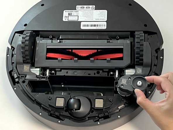

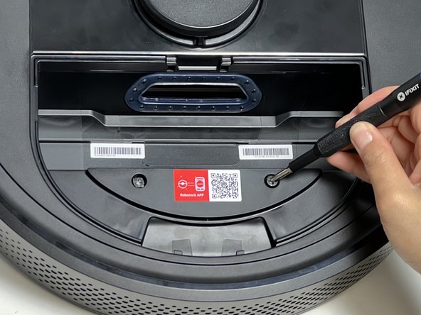

    • Power off your Roborock and place the device on a flat surface with the wheels facing up.
    • Position the robot so the five-pronged side brush is on the bottom right side.
  2. Roborock Q5 LiDar Sensor Replacement: crwdns2935265:02crwdnd2935265:01crwdnd2935265:02crwdne2935265:0 Roborock Q5 LiDar Sensor Replacement: crwdns2935265:02crwdnd2935265:02crwdnd2935265:02crwdne2935265:0
    • Use a Phillips #2 screwdriver to loosen the single captive side brush screw.
    • The screw is attached to the side brush so they cannot be separated.
  3. Roborock Q5 LiDar Sensor Replacement: crwdns2935265:03crwdnd2935265:01crwdnd2935265:02crwdne2935265:0 Roborock Q5 LiDar Sensor Replacement: crwdns2935265:03crwdnd2935265:02crwdnd2935265:02crwdne2935265:0
    • Lift the side brush up and off.

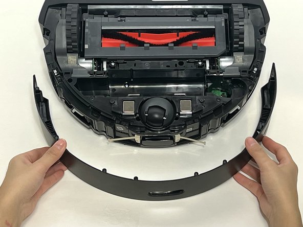

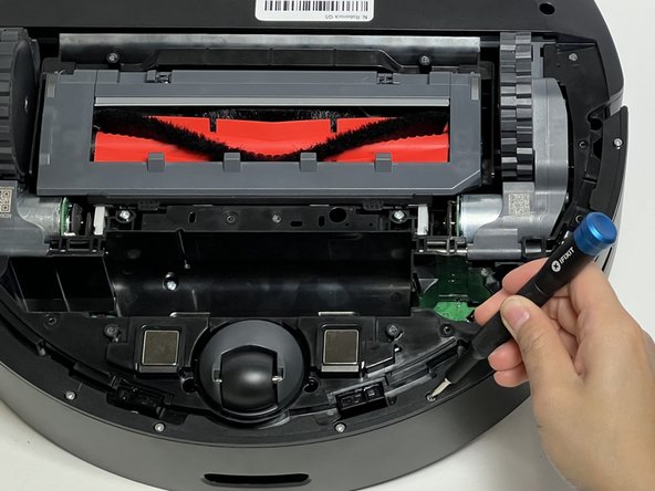

    • Use a Phillips screwdriver to remove the seven 15 mm screws from the bottom panel.
  5. Roborock Q5 LiDar Sensor Replacement: crwdns2935265:05crwdnd2935265:01crwdnd2935265:03crwdne2935265:0 Roborock Q5 LiDar Sensor Replacement: crwdns2935265:05crwdnd2935265:02crwdnd2935265:03crwdne2935265:0 Roborock Q5 LiDar Sensor Replacement: crwdns2935265:05crwdnd2935265:03crwdnd2935265:03crwdne2935265:0
    • Gently lift off the bottom panel cover.
    • If the bottom panel is stuck, use a plastic spudger along the edges to gently lift it out of place, then remove it by hand.

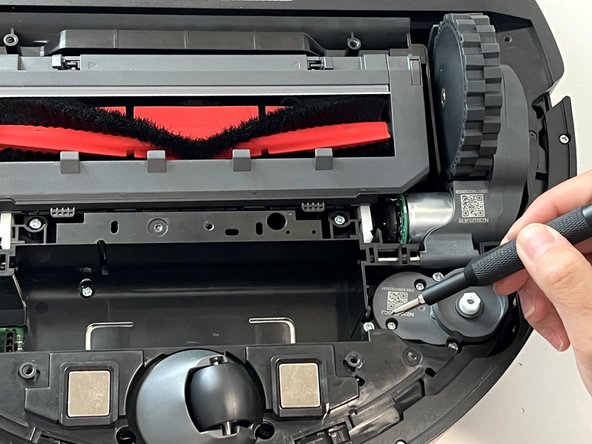

    • Remove the three 10 mm Phillips screws that secure the side brush motor.
    • Lift the side brush motor up and out of its housing.

    • Use a Phillips screwdriver to remove one 14 mm Phillips screw from the battery housing.
    • Use a Phillips screwdriver to remove the eleven deep-set 14 mm Phillips screws from the bottom panel.

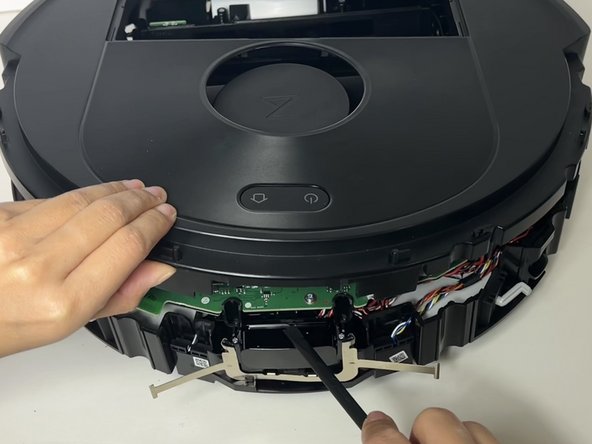

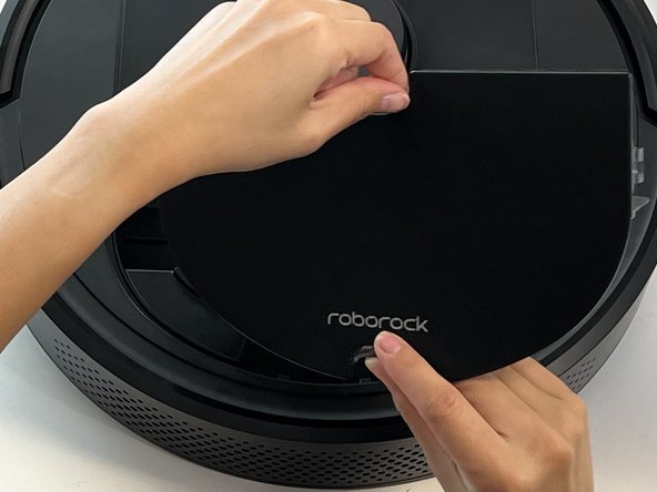

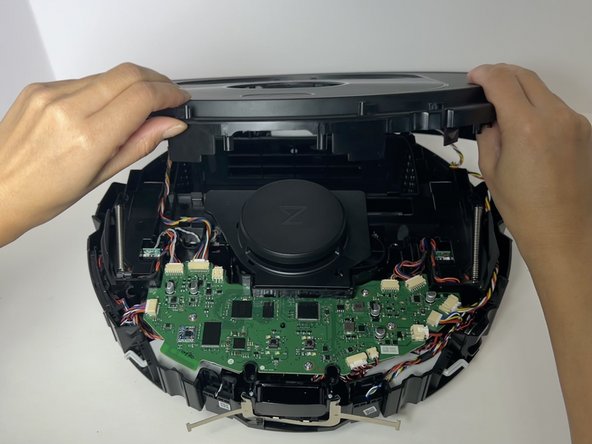

    • Gently lift and remove the top cover off of the robot vacuum.
    • If the top panel is stuck, use a plastic spudger along the edges to gently lift it out of place, then remove it by hand.

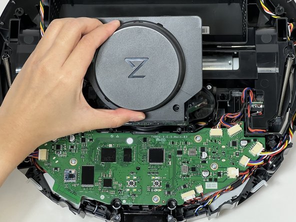

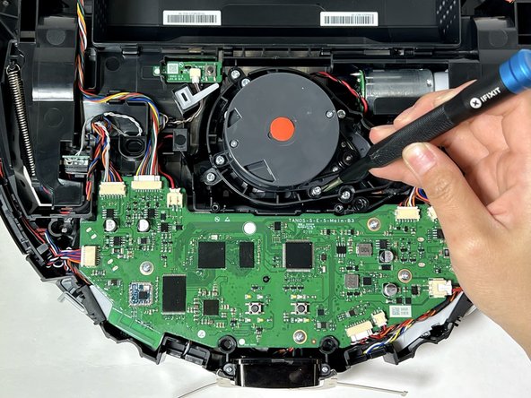

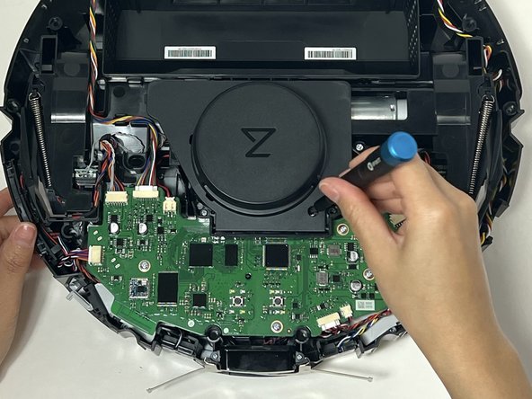

  15. Roborock Q5 LiDar Sensor Replacement: crwdns2935265:015crwdnd2935265:01crwdnd2935265:03crwdne2935265:0 Roborock Q5 LiDar Sensor Replacement: crwdns2935265:015crwdnd2935265:02crwdnd2935265:03crwdne2935265:0 Roborock Q5 LiDar Sensor Replacement: crwdns2935265:015crwdnd2935265:03crwdnd2935265:03crwdne2935265:0

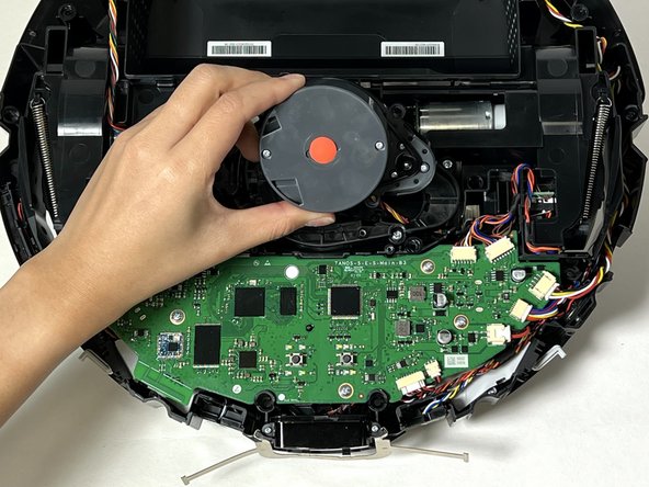

    • Use a Phillips #1 screwdriver to remove the two 10 mm screws from the LiDar sensor cover.
    • Gently lift off the sensor cover.
  16. Roborock Q5 LiDar Sensor Replacement: crwdns2935265:016crwdnd2935265:01crwdnd2935265:03crwdne2935265:0 Roborock Q5 LiDar Sensor Replacement: crwdns2935265:016crwdnd2935265:02crwdnd2935265:03crwdne2935265:0 Roborock Q5 LiDar Sensor Replacement: crwdns2935265:016crwdnd2935265:03crwdnd2935265:03crwdne2935265:0

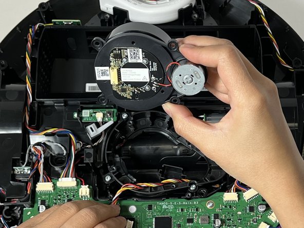

    • Use a Phillips #1 screwdriver to remove the four 9 mm screws that secure the LiDar sensor.
    • Lift the sensor from the vacuum.

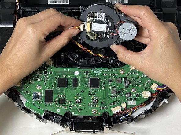

  17. Roborock Q5 LiDar Sensor Replacement: crwdns2935265:017crwdnd2935265:01crwdnd2935265:03crwdne2935265:0 Roborock Q5 LiDar Sensor Replacement: crwdns2935265:017crwdnd2935265:02crwdnd2935265:03crwdne2935265:0 Roborock Q5 LiDar Sensor Replacement: crwdns2935265:017crwdnd2935265:03crwdnd2935265:03crwdne2935265:0
    • Grip and the white LiDar sensor cable connector and pull it directly out of its socket.
    • Remove the LiDar sensor.

The replacement lidar sensor is available on Ali Express. OEM model # is LDS04RR. Here's a link to the correct part (as of Sept 2025): Original Roborock LDS Replacement LDS04RR For Robot Vacuum Cleaner Q5 / Q7/ Q7 Max / S8 Series Accessories Laser Distance Sensor - AliExpress
Before replacing, take a good look at the motor shaft of the lidar sensor - it can get tangled with hair and lint and may be the reason your sensor is not spinning. Cleaning the shaft may save the need for a new part (but not the hassle of dissassembly)
