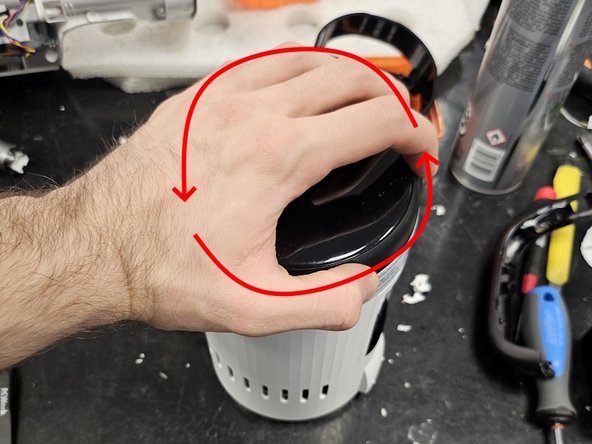

  1. Roborock Dyad Pro Combo: Fan Unit Teardown, Removing the display: crwdns2935265:01crwdnd2935265:01crwdnd2935265:03crwdne2935265:0 Roborock Dyad Pro Combo: Fan Unit Teardown, Removing the display: crwdns2935265:01crwdnd2935265:02crwdnd2935265:03crwdne2935265:0 Roborock Dyad Pro Combo: Fan Unit Teardown, Removing the display: crwdns2935265:01crwdnd2935265:03crwdnd2935265:03crwdne2935265:0
    • Start by grabbing the display and twisting it counter clockwise.
    • This may require a lot or a little bit of force. Eventually it will give and at that point you can lift it up.
    • Once removing the display, remove the cable connecting it.

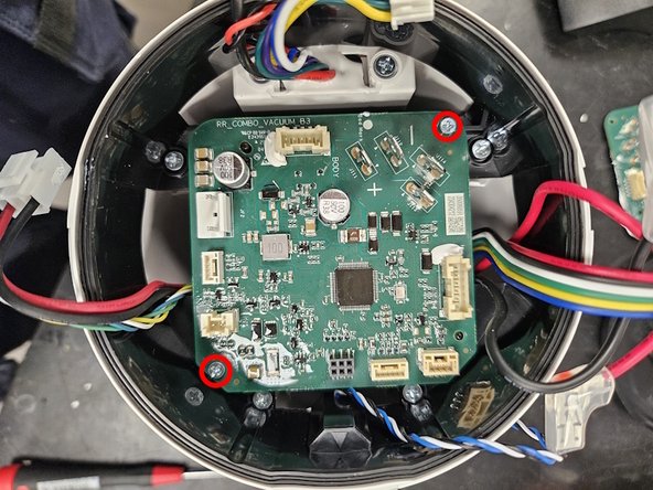

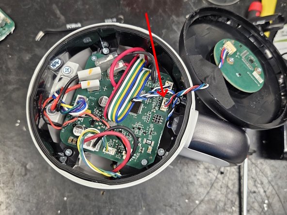

  2. Roborock Dyad Pro Combo: Fan Unit Teardown, Removing the motherboard: crwdns2935265:02crwdnd2935265:01crwdnd2935265:02crwdne2935265:0 Roborock Dyad Pro Combo: Fan Unit Teardown, Removing the motherboard: crwdns2935265:02crwdnd2935265:02crwdnd2935265:02crwdne2935265:0
    • Remove all the cables from the motherboard.
    • Then remove the 2 screws and take the motherboard out.
    • Use this as a reference during reassembly or take a better picture yourself.

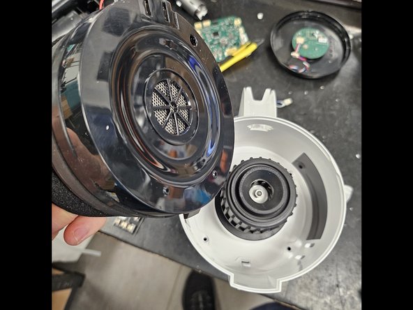

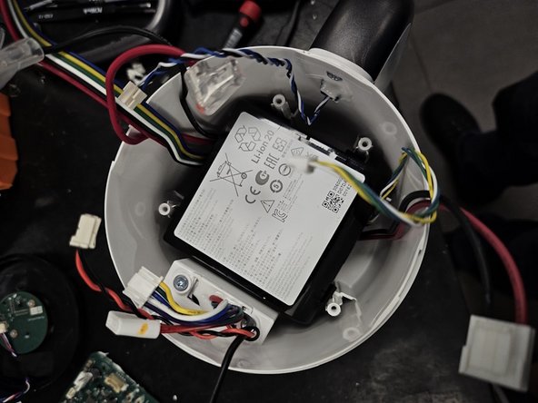

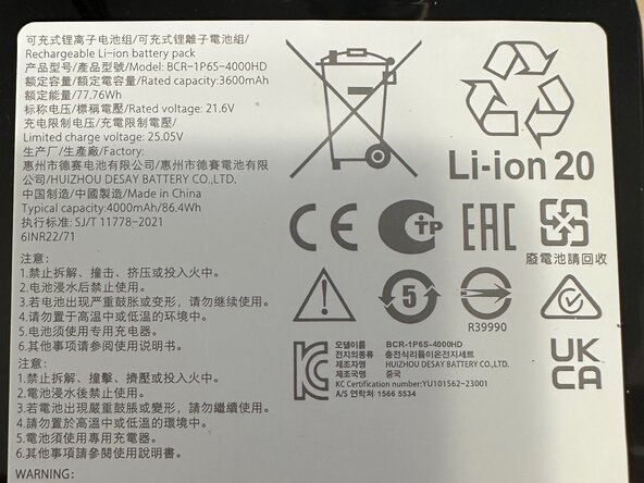

  3. Roborock Dyad Pro Combo: Fan Unit Teardown, Removing the battery: crwdns2935265:03crwdnd2935265:01crwdnd2935265:03crwdne2935265:0 Roborock Dyad Pro Combo: Fan Unit Teardown, Removing the battery: crwdns2935265:03crwdnd2935265:02crwdnd2935265:03crwdne2935265:0 Roborock Dyad Pro Combo: Fan Unit Teardown, Removing the battery: crwdns2935265:03crwdnd2935265:03crwdnd2935265:03crwdne2935265:0
    • Remove the plastic housing.
    • Remove the battery. (It is not held in place by anything. Just pull it out.)

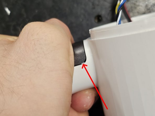

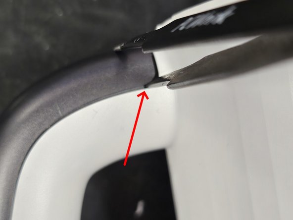

  5. Roborock Dyad Pro Combo: Fan Unit Teardown, Handle pt.1: crwdns2935265:05crwdnd2935265:01crwdnd2935265:03crwdne2935265:0 Roborock Dyad Pro Combo: Fan Unit Teardown, Handle pt.1: crwdns2935265:05crwdnd2935265:02crwdnd2935265:03crwdne2935265:0 Roborock Dyad Pro Combo: Fan Unit Teardown, Handle pt.1: crwdns2935265:05crwdnd2935265:03crwdnd2935265:03crwdne2935265:0
    • Remove the screw from the inside.
    • Use your hand to force a small gap between the handle and the housing.
    • Fit blunt-tipped tweezers or a small flat head screwdriver into the gap.

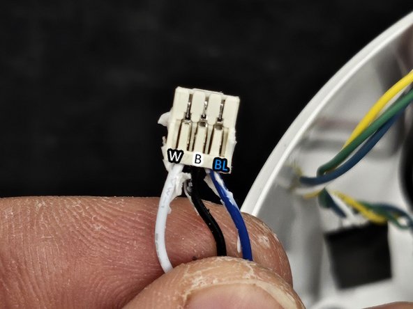

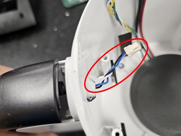

  6. Roborock Dyad Pro Combo: Fan Unit Teardown, Handle pt.2: crwdns2935265:06crwdnd2935265:01crwdnd2935265:03crwdne2935265:0 Roborock Dyad Pro Combo: Fan Unit Teardown, Handle pt.2: crwdns2935265:06crwdnd2935265:02crwdnd2935265:03crwdne2935265:0 Roborock Dyad Pro Combo: Fan Unit Teardown, Handle pt.2: crwdns2935265:06crwdnd2935265:03crwdnd2935265:03crwdne2935265:0
    • Push it upwards, until it won't re-seat by itself.
    • Push the cable as far into the handle as it will go to prevent damaging it once you get the handle apart.
    • If you do happen to pull a cable from the connector, the last image is a reference to how it's meant to be assembled. Try to reassemble it if you pull a cable out.

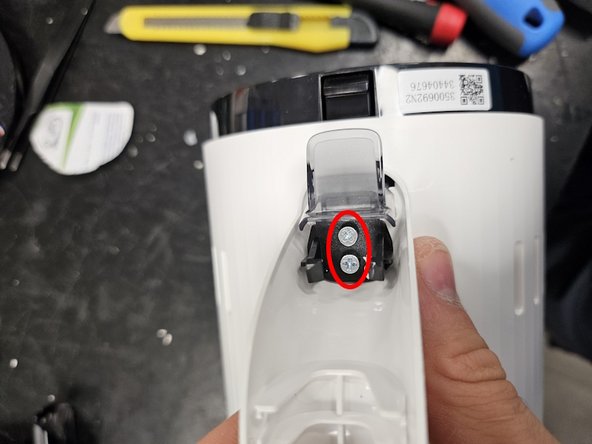

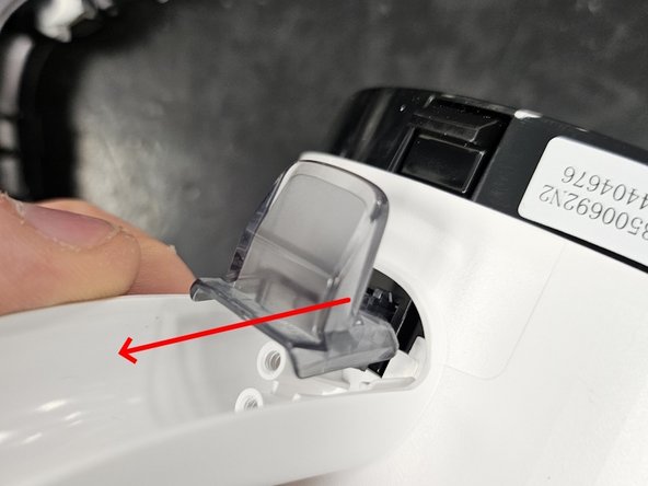

  7. Roborock Dyad Pro Combo: Fan Unit Teardown, Handle pt.3: crwdns2935265:07crwdnd2935265:01crwdnd2935265:03crwdne2935265:0 Roborock Dyad Pro Combo: Fan Unit Teardown, Handle pt.3: crwdns2935265:07crwdnd2935265:02crwdnd2935265:03crwdne2935265:0 Roborock Dyad Pro Combo: Fan Unit Teardown, Handle pt.3: crwdns2935265:07crwdnd2935265:03crwdnd2935265:03crwdne2935265:0
    • Remove the handle by defeating the latches using a Plastic card or iFixit's Jimmy.
    • Remove the screws, then remove the black plastic retainer.
    • Remove the grey lever by pulling it off. It is latched onto the main assembly.

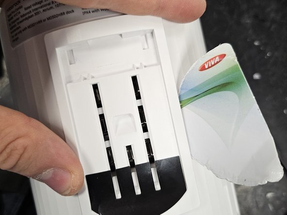

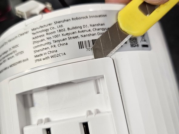

  8. Roborock Dyad Pro Combo: Fan Unit Teardown, Connector PCBA assembly pt.1: crwdns2935265:08crwdnd2935265:01crwdnd2935265:03crwdne2935265:0 Roborock Dyad Pro Combo: Fan Unit Teardown, Connector PCBA assembly pt.1: crwdns2935265:08crwdnd2935265:02crwdnd2935265:03crwdne2935265:0 Roborock Dyad Pro Combo: Fan Unit Teardown, Connector PCBA assembly pt.1: crwdns2935265:08crwdnd2935265:03crwdnd2935265:03crwdne2935265:0
    • Back inside, remove the 2 screws by the bunch of cables.
    • Move to the outside and force a gap between the main housing and the electrical contacts housing.
    • Use a plastic card to get the rest of the latches to unlatch.

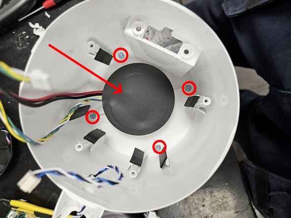

  9. Roborock Dyad Pro Combo: Fan Unit Teardown, Connector PCBA assembly pt.2: crwdns2935265:09crwdnd2935265:01crwdnd2935265:02crwdne2935265:0 Roborock Dyad Pro Combo: Fan Unit Teardown, Connector PCBA assembly pt.2: crwdns2935265:09crwdnd2935265:02crwdnd2935265:02crwdne2935265:0
    • Remove the PCBA and the cable leading from the bottom.
    • Back inside, remove the 4 screws and the black foam on the bottom.
