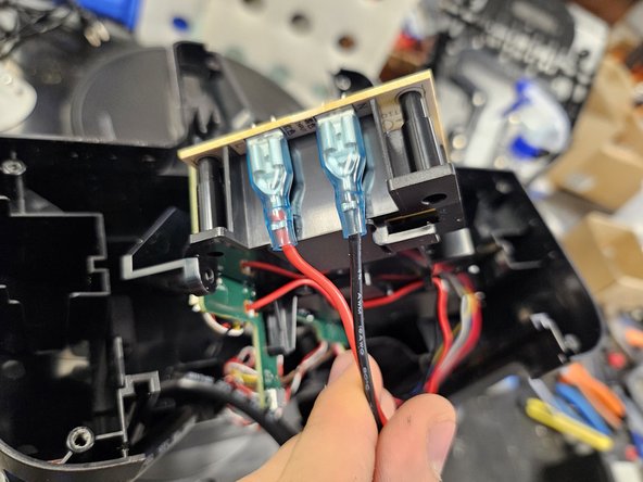

  3. Roborock Auto-empty Dock (Onyx): Teardown: crwdns2935265:03crwdnd2935265:01crwdnd2935265:03crwdne2935265:0 Roborock Auto-empty Dock (Onyx): Teardown: crwdns2935265:03crwdnd2935265:02crwdnd2935265:03crwdne2935265:0 Roborock Auto-empty Dock (Onyx): Teardown: crwdns2935265:03crwdnd2935265:03crwdnd2935265:03crwdne2935265:0
    • Remove the marked screws.
    • All are PH1.
    • Bend the contacts back (img3) to prevent them from shorting the PSU once you pull the assembly out.

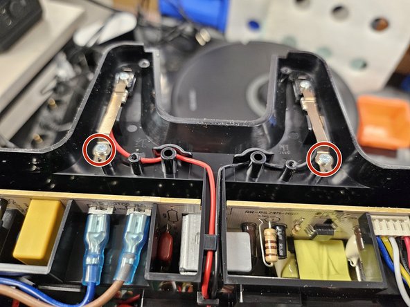

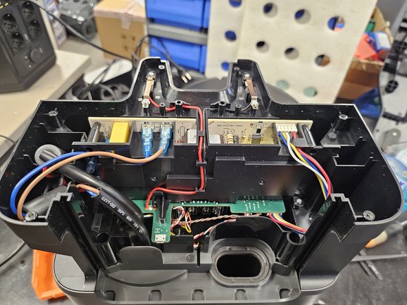

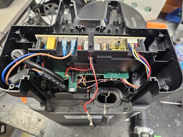

  4. Roborock Auto-empty Dock (Onyx): Teardown: crwdns2935265:04crwdnd2935265:01crwdnd2935265:02crwdne2935265:0 Roborock Auto-empty Dock (Onyx): Teardown: crwdns2935265:04crwdnd2935265:02crwdnd2935265:02crwdne2935265:0
    • Remove the cables.
    • Use these images as reference when reassembling.

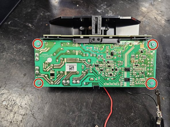

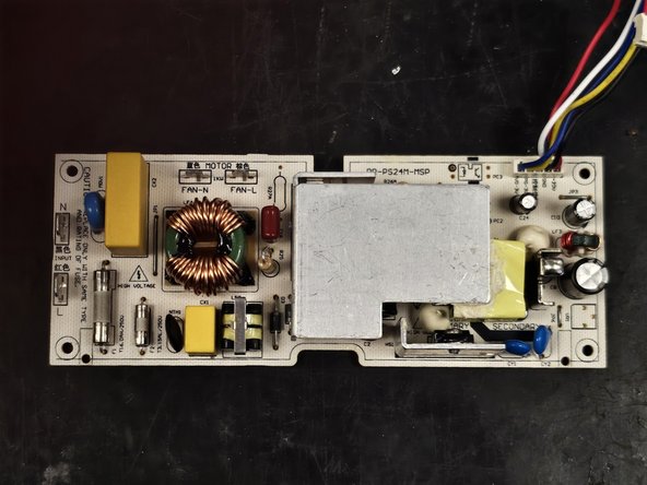

  5. Roborock Auto-empty Dock (Onyx): Teardown: crwdns2935265:05crwdnd2935265:01crwdnd2935265:03crwdne2935265:0 Roborock Auto-empty Dock (Onyx): Teardown: crwdns2935265:05crwdnd2935265:02crwdnd2935265:03crwdne2935265:0 Roborock Auto-empty Dock (Onyx): Teardown: crwdns2935265:05crwdnd2935265:03crwdnd2935265:03crwdne2935265:0
    • Take out the PCBA+PSU assembly.
    • When taking out the assembly, make sure to disconnect the other connectors. I forgot to take pictures of these, so just take it out carefully.
    • Remove the connecting cable between the PSU and the main PBCA.
    • Unscrew the PSU.
    • Remove the PSU.
