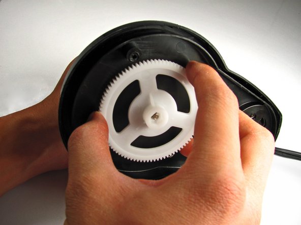

  7. Rival Mini Chopper MC-67BL Power Button Replacement: crwdns2935265:07crwdnd2935265:01crwdnd2935265:01crwdne2935265:0
    • Remove the smaller white gear by lifting it up with your hand.

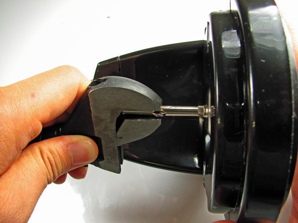

  8. Rival Mini Chopper MC-67BL Power Button Replacement: crwdns2935265:08crwdnd2935265:01crwdnd2935265:03crwdne2935265:0 Rival Mini Chopper MC-67BL Power Button Replacement: crwdns2935265:08crwdnd2935265:02crwdnd2935265:03crwdne2935265:0 Rival Mini Chopper MC-67BL Power Button Replacement: crwdns2935265:08crwdnd2935265:03crwdnd2935265:03crwdne2935265:0
    • Use a pair of pliers or any other clamping tool to securely hold the blade-shaft that sits above the base.
    • Grab the gear with your other hand and turn CLOCKWISE. Unlike most screws, the gear is reverse-threaded to allow the blade to spin.
    • Continue turning the gear until completely removed from the blade-shaft.

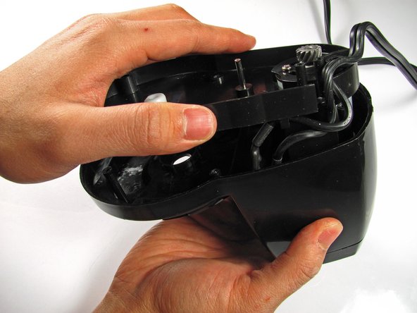

  12. Rival Mini Chopper MC-67BL Power Button Replacement: crwdns2935265:012crwdnd2935265:01crwdnd2935265:02crwdne2935265:0 Rival Mini Chopper MC-67BL Power Button Replacement: crwdns2935265:012crwdnd2935265:02crwdnd2935265:02crwdne2935265:0
    • Use the plastic opening tool to pry open the base from the main body.
    • These two plastic prongs are pressed fit into the base. It may take some effort to pry the base completely off.
    • Once freed, lift the base panel from the main body and set it aside.

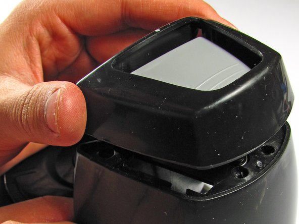

  13. Rival Mini Chopper MC-67BL Power Button Replacement: crwdns2935265:013crwdnd2935265:01crwdnd2935265:02crwdne2935265:0 Rival Mini Chopper MC-67BL Power Button Replacement: crwdns2935265:013crwdnd2935265:02crwdnd2935265:02crwdne2935265:0
    • Use a Phillips #2 screwdriver to remove the three 9.53-mm screws from inside the main body.
    • Next, turn the device upright and lift the upper casing from around the button gently.
