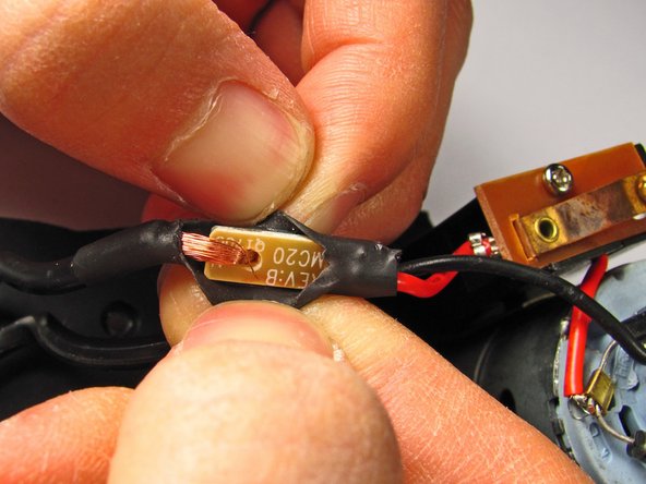

  17. Rival Mini Chopper MC-67BL Motor Replacement: crwdns2935265:017crwdnd2935265:01crwdnd2935265:01crwdne2935265:0
    • Use a small knife to cut the copper wires from the bracket holding the black wire and power cord together.
    • For reassembly the copper wires will need to be soldered together.
