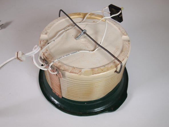

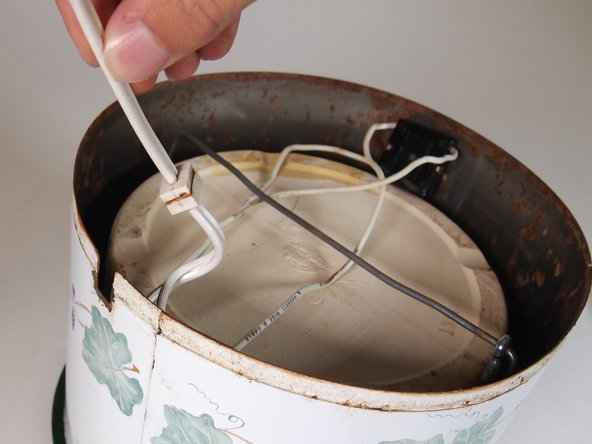

    • Slide the power cord out of its slot in the metal casing.
  8. Rival Crock Pot 3120 Disassembly: crwdns2935265:08crwdnd2935265:01crwdnd2935265:02crwdne2935265:0 Rival Crock Pot 3120 Disassembly: crwdns2935265:08crwdnd2935265:02crwdnd2935265:02crwdne2935265:0
    • Pull the rotary switch out from inside the metal casing.
  9. Rival Crock Pot 3120 Disassembly: crwdns2935265:09crwdnd2935265:01crwdnd2935265:03crwdne2935265:0 Rival Crock Pot 3120 Disassembly: crwdns2935265:09crwdnd2935265:02crwdnd2935265:03crwdne2935265:0 Rival Crock Pot 3120 Disassembly: crwdns2935265:09crwdnd2935265:03crwdnd2935265:03crwdne2935265:0
    • Slide the metal casing up and away from the internal components of the device.
