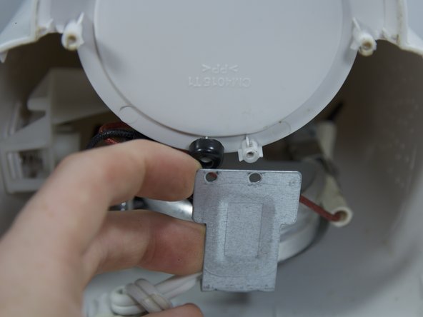

  3. Rival CM4015 Water Tubes Replacement, Power Button: crwdns2935265:03crwdnd2935265:01crwdnd2935265:01crwdne2935265:0
    • Remove the 8mm Phillips screw that attaches the power button to the inside of the coffee maker.

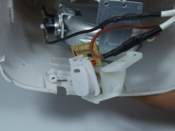

  4. Rival CM4015 Water Tubes Replacement: crwdns2935265:04crwdnd2935265:01crwdnd2935265:02crwdne2935265:0 Rival CM4015 Water Tubes Replacement: crwdns2935265:04crwdnd2935265:02crwdnd2935265:02crwdne2935265:0
    • Use a flat head screwdriver to pry the power button from its slot in the body of the device.
    • Make sure the tool is pressed securely under the plastic clip, in order to not break it.

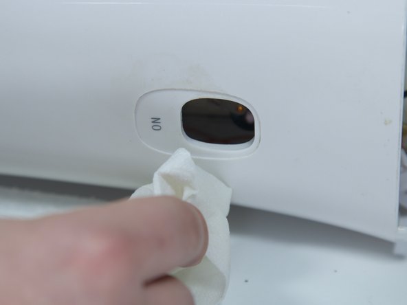

  5. Rival CM4015 Water Tubes Replacement: crwdns2935265:05crwdnd2935265:01crwdnd2935265:02crwdne2935265:0 Rival CM4015 Water Tubes Replacement: crwdns2935265:05crwdnd2935265:02crwdnd2935265:02crwdne2935265:0
    • Clean both the button and its slot before replacing the power button.

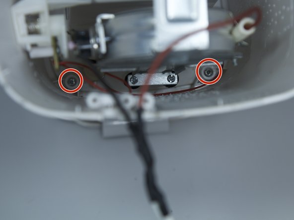

  6. Rival CM4015 Water Tubes Replacement, Heating Element: crwdns2935265:06crwdnd2935265:01crwdnd2935265:01crwdne2935265:0
    • Remove the two 8 mm Phillips screws from the plastic body.
  7. Rival CM4015 Water Tubes Replacement: crwdns2935265:07crwdnd2935265:01crwdnd2935265:02crwdne2935265:0 Rival CM4015 Water Tubes Replacement: crwdns2935265:07crwdnd2935265:02crwdnd2935265:02crwdne2935265:0
    • Remove the two 8 mm Phillips screws from the chassis of coffee maker.
    • Pull back the metal backing from the plastic body.

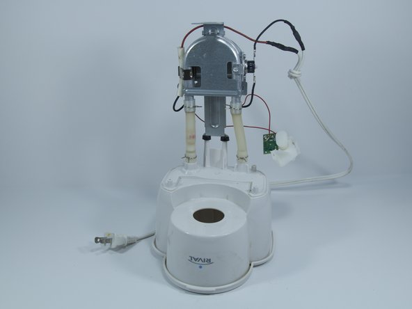

  11. Rival CM4015 Water Tubes Replacement: crwdns2935265:011crwdnd2935265:01crwdnd2935265:01crwdne2935265:0
    • Remove the 4 springs holding the water tubes by squeezing the 2 prongs together.
    • You may also use pliers for this step if the springs are too strong.
  12. Rival CM4015 Water Tubes Replacement: crwdns2935265:012crwdnd2935265:01crwdnd2935265:01crwdne2935265:0
    • Bend the heating element back and forth to wiggle the water tubes loose from the plastic.
  13. Rival CM4015 Water Tubes Replacement, Water Tubes: crwdns2935265:013crwdnd2935265:01crwdnd2935265:01crwdne2935265:0
    • Remove the two rubber water tubes from the heating element by firmly pulling each at a 90 degree angle from the socket.
