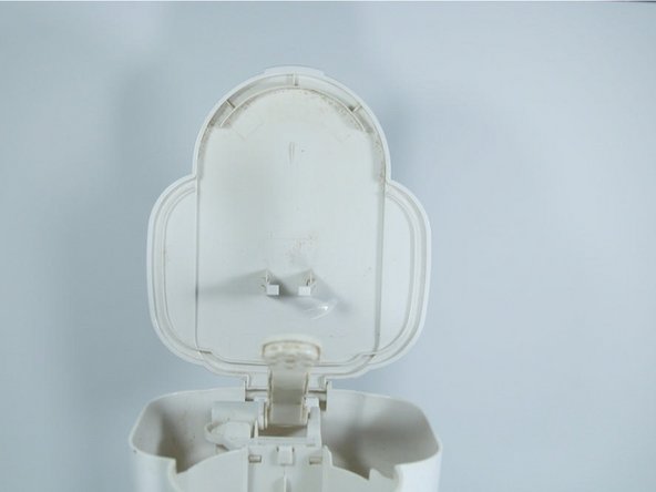

    • Lift lid up to an open position.

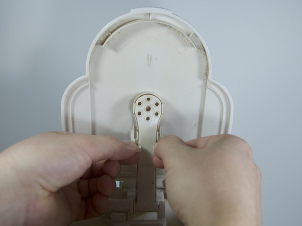

  3. Rival CM4015 Lid Replacement: crwdns2935265:03crwdnd2935265:01crwdnd2935265:03crwdne2935265:0 Rival CM4015 Lid Replacement: crwdns2935265:03crwdnd2935265:02crwdnd2935265:03crwdne2935265:0 Rival CM4015 Lid Replacement: crwdns2935265:03crwdnd2935265:03crwdnd2935265:03crwdne2935265:0
    • Locate the plastic clips keeping the lid in place.
    • Pull the clips apart to free the lid.

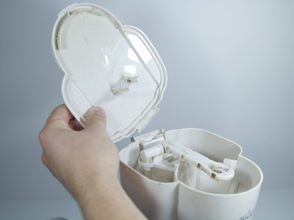

  4. Rival CM4015 Lid Replacement: crwdns2935265:04crwdnd2935265:01crwdnd2935265:02crwdne2935265:0 Rival CM4015 Lid Replacement: crwdns2935265:04crwdnd2935265:02crwdnd2935265:02crwdne2935265:0
    • Lift the lid up in order to separate it from the coffee maker.
    • It may take some force to detach the lid.
