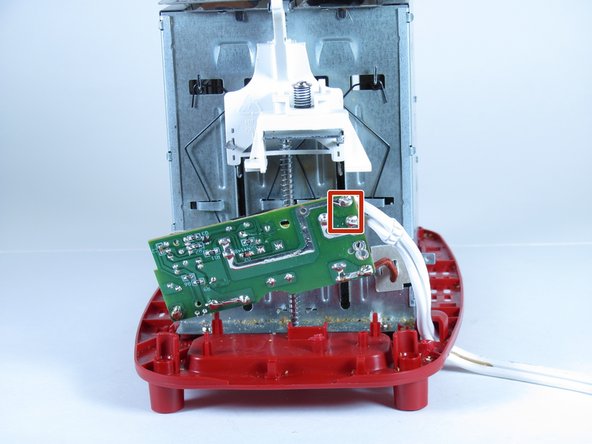

    1. Rival 16131 Toaster Power Wire Repair, Rival 16131 Toaster Power Wire Repair: crwdns2935265:05crwdnd2935265:01crwdnd2935265:02crwdne2935265:0 Rival 16131 Toaster Power Wire Repair, Rival 16131 Toaster Power Wire Repair: crwdns2935265:05crwdnd2935265:02crwdnd2935265:02crwdne2935265:0
      • The power wire connects to the toaster in the area highlighted.
      • To free the wire, unscrew the two .5 inch screws, and remove the white brace.
    2. Rival 16131 Toaster Power Wire Repair: crwdns2935265:06crwdnd2935265:01crwdnd2935265:01crwdne2935265:0
      • To solder the the wire, the circuit board has to be released.
      • To do this, unscrew the .5 inch screw located in the middle of the board.
      • Slowly lift the board up off the toaster, making sure that the red pegs that hold the board in place do not break.
    3. Rival 16131 Toaster Power Wire Repair: crwdns2935265:07crwdnd2935265:01crwdnd2935265:01crwdne2935265:0
      • To reattach the wire, follow this solder guide.
      • Solder Guide
