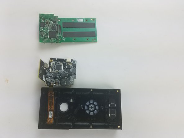

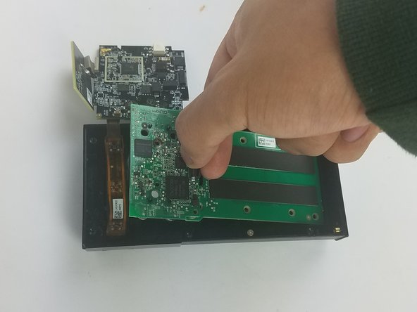

  3. Ring Video Doorbell Housing Replacement: crwdns2935265:03crwdnd2935265:01crwdnd2935265:03crwdne2935265:0 Ring Video Doorbell Housing Replacement: crwdns2935265:03crwdnd2935265:02crwdnd2935265:03crwdne2935265:0 Ring Video Doorbell Housing Replacement: crwdns2935265:03crwdnd2935265:03crwdnd2935265:03crwdne2935265:0
    • Unscrew the 9 1 mm screwdrivers using a PH00 Phillips Screwdriver.
    • Carefully detach the motherboard, from the housing unit using your hands.
