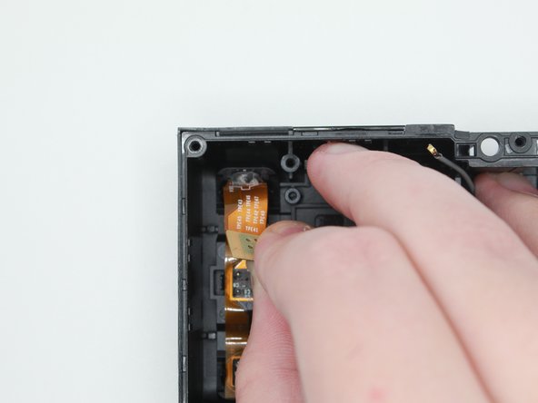

  5. Ring Video Doorbell 3 Camera Sensor Replacement: crwdns2935265:05crwdnd2935265:01crwdnd2935265:02crwdne2935265:0 Ring Video Doorbell 3 Camera Sensor Replacement: crwdns2935265:05crwdnd2935265:02crwdnd2935265:02crwdne2935265:0
    • Put your thumb where the battery was and push outwards to remove the back case.
  6. Ring Video Doorbell 3 Camera Sensor Replacement: crwdns2935265:06crwdnd2935265:01crwdnd2935265:03crwdne2935265:0 Ring Video Doorbell 3 Camera Sensor Replacement: crwdns2935265:06crwdnd2935265:02crwdnd2935265:03crwdne2935265:0 Ring Video Doorbell 3 Camera Sensor Replacement: crwdns2935265:06crwdnd2935265:03crwdnd2935265:03crwdne2935265:0
