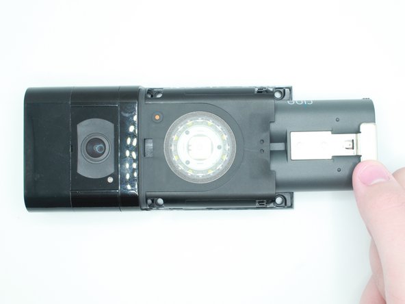

    • Look at the bottom of the device and locate the arrow.
    • Use your fingers to push the silver faceplate in the direction of the arrow.
  2. Ring Video Doorbell 3 Camera Replacement: crwdns2935265:02crwdnd2935265:01crwdnd2935265:01crwdne2935265:0
    • Push up to take the face plate off.
  3. Ring Video Doorbell 3 Camera Replacement, Battery: crwdns2935265:03crwdnd2935265:01crwdnd2935265:02crwdne2935265:0 Ring Video Doorbell 3 Camera Replacement, Battery: crwdns2935265:03crwdnd2935265:02crwdnd2935265:02crwdne2935265:0
    • Push in the silver tab and slide the battery out.

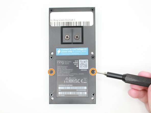

  4. Ring Video Doorbell 3 Camera Replacement, Motherboard: crwdns2935265:04crwdnd2935265:01crwdnd2935265:03crwdne2935265:0 Ring Video Doorbell 3 Camera Replacement, Motherboard: crwdns2935265:04crwdnd2935265:02crwdnd2935265:03crwdne2935265:0 Ring Video Doorbell 3 Camera Replacement, Motherboard: crwdns2935265:04crwdnd2935265:03crwdnd2935265:03crwdne2935265:0

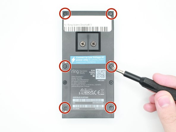

    • Remove the 6 screws with a Torx T6 screwdriver.
    • Remove the 2 screws with a Torx T5 screwdriver.

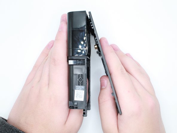

  5. Ring Video Doorbell 3 Camera Replacement: crwdns2935265:05crwdnd2935265:01crwdnd2935265:02crwdne2935265:0 Ring Video Doorbell 3 Camera Replacement: crwdns2935265:05crwdnd2935265:02crwdnd2935265:02crwdne2935265:0
    • Put your thumb where the battery was and push outwards to remove the back case.

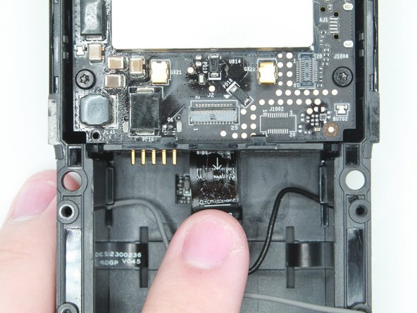

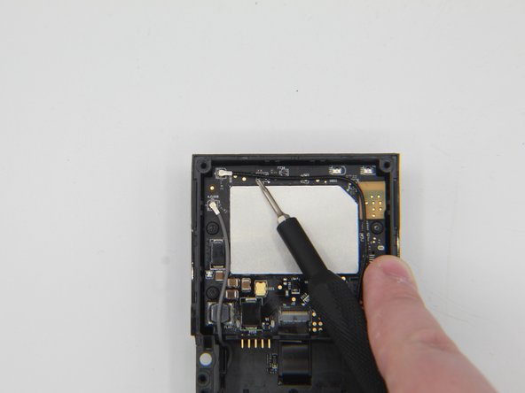

  6. Ring Video Doorbell 3 Camera Replacement: crwdns2935265:06crwdnd2935265:01crwdnd2935265:03crwdne2935265:0 Ring Video Doorbell 3 Camera Replacement: crwdns2935265:06crwdnd2935265:02crwdnd2935265:03crwdne2935265:0 Ring Video Doorbell 3 Camera Replacement: crwdns2935265:06crwdnd2935265:03crwdnd2935265:03crwdne2935265:0
    • Get a tweezer, and remove the black and grey antenna wires.

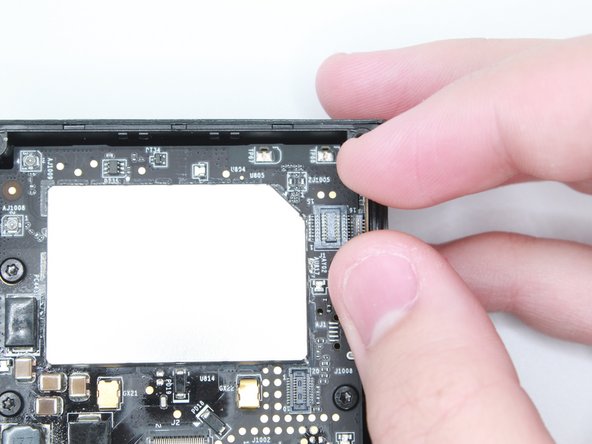

    • Disconnect the camera sensor.
  8. Ring Video Doorbell 3 Camera Replacement: crwdns2935265:08crwdnd2935265:01crwdnd2935265:02crwdne2935265:0 Ring Video Doorbell 3 Camera Replacement: crwdns2935265:08crwdnd2935265:02crwdnd2935265:02crwdne2935265:0
    • Be cautious to not rip the ribbon cable.
    • Lift the black tab above the ribbon to unlock it.
    • Use the tweezers to pull out the ribbon.

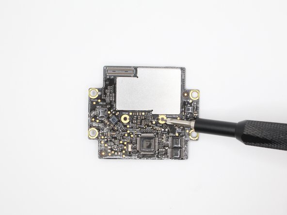

  9. Ring Video Doorbell 3 Camera Replacement: crwdns2935265:09crwdnd2935265:01crwdnd2935265:02crwdne2935265:0 Ring Video Doorbell 3 Camera Replacement: crwdns2935265:09crwdnd2935265:02crwdnd2935265:02crwdne2935265:0
    • Use a Torx T6 but to take out the four screws on the first motherboard.

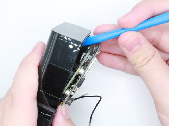

  10. Ring Video Doorbell 3 Camera Replacement: crwdns2935265:010crwdnd2935265:01crwdnd2935265:02crwdne2935265:0 Ring Video Doorbell 3 Camera Replacement: crwdns2935265:010crwdnd2935265:02crwdnd2935265:02crwdne2935265:0
    • Use an opening tool to take out the motherboard.
    • Make sure to push in the 5 pins while taking out the motherboards to ensure that they do not break.

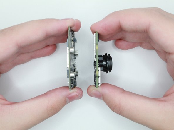

  12. Ring Video Doorbell 3 Camera Replacement: crwdns2935265:012crwdnd2935265:01crwdnd2935265:02crwdne2935265:0 Ring Video Doorbell 3 Camera Replacement: crwdns2935265:012crwdnd2935265:02crwdnd2935265:02crwdne2935265:0
    • Flip the two boards on the side.
    • Gently pull the motherboard and the camera board apart.

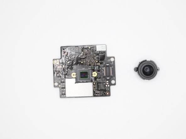

  13. Ring Video Doorbell 3 Camera Replacement: crwdns2935265:013crwdnd2935265:01crwdnd2935265:02crwdne2935265:0 Ring Video Doorbell 3 Camera Replacement: crwdns2935265:013crwdnd2935265:02crwdnd2935265:02crwdne2935265:0
    • Use the Phillips #00 screwdriver to remove the two screws.
  14. Ring Video Doorbell 3 Camera Replacement: crwdns2935265:014crwdnd2935265:01crwdnd2935265:02crwdne2935265:0 Ring Video Doorbell 3 Camera Replacement: crwdns2935265:014crwdnd2935265:02crwdnd2935265:02crwdne2935265:0
    • Carefully remove the camera lens from the board.
    • Replace Motherboard(s) if needed.
    • Replace Camera if needed.
