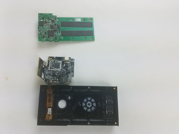

    • Unscrew the 9 1 mm screwdrivers using a PH00 Phillips Screwdriver.
    • Carefully detach the motherboard, from the housing unit using your hands.

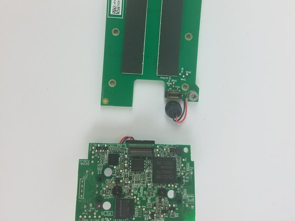

  4. Ring Video Doorbell  Speakers Replacement: crwdns2935265:04crwdnd2935265:01crwdnd2935265:02crwdne2935265:0 Ring Video Doorbell  Speakers Replacement: crwdns2935265:04crwdnd2935265:02crwdnd2935265:02crwdne2935265:0
    • Detach the upper part of the motherboard from the bottom, using your hands.
  5. Ring Video Doorbell  Speakers Replacement, Speakers: crwdns2935265:05crwdnd2935265:01crwdnd2935265:01crwdne2935265:0
    • Speakers are two small rectangles located above the button of the doorbell.
  6. Ring Video Doorbell  Speakers Replacement: crwdns2935265:06crwdnd2935265:01crwdnd2935265:01crwdne2935265:0
    • To remove the speakers pry each one out carefully with a plastic opening tool.
