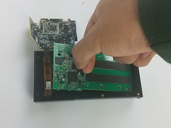

      • Pry open the back case as shown using the Plastic Opening Tool.
      • Disconnect the battery from motherboard by carefully pulling up on the connector.
    3. Ring Video Doorbell  Camera Replacement: crwdns2935265:03crwdnd2935265:01crwdnd2935265:03crwdne2935265:0 Ring Video Doorbell  Camera Replacement: crwdns2935265:03crwdnd2935265:02crwdnd2935265:03crwdne2935265:0 Ring Video Doorbell  Camera Replacement: crwdns2935265:03crwdnd2935265:03crwdnd2935265:03crwdne2935265:0
      • Unscrew the 9 1 mm screwdrivers using a PH00 Phillips Screwdriver.
      • Carefully detach the motherboard, from the housing unit using your hands.

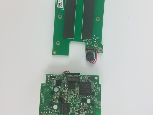

    4. Ring Video Doorbell  Camera Replacement: crwdns2935265:04crwdnd2935265:01crwdnd2935265:02crwdne2935265:0 Ring Video Doorbell  Camera Replacement: crwdns2935265:04crwdnd2935265:02crwdnd2935265:02crwdne2935265:0
      • Using the Plating Tool Opener, arefully disconnect the ribbon cable that attaches the camera to the housing.
      • Replace camera, and follow the steps in reverse order to reassemble

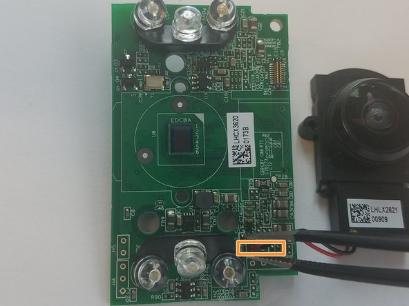

    5. Ring Video Doorbell  Camera Replacement: crwdns2935265:05crwdnd2935265:01crwdnd2935265:02crwdne2935265:0 Ring Video Doorbell  Camera Replacement: crwdns2935265:05crwdnd2935265:02crwdnd2935265:02crwdne2935265:0
      • Unscrew the two 1 mm screws using the PH00 Philips Screwdriver.
      • Detach the black and red wire connected to the motherboard, using the tweezers, to remove the camera.
