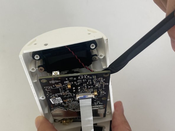

  10. Ring Stick Up Cam Battery Motherboard Replacement: crwdns2935265:010crwdnd2935265:01crwdnd2935265:02crwdne2935265:0 Ring Stick Up Cam Battery Motherboard Replacement: crwdns2935265:010crwdnd2935265:02crwdnd2935265:02crwdne2935265:0
    • Lift the motherboard from the camera body with the halberd spudger.

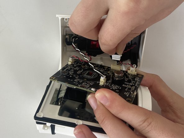

    • Rotate the device to its side.
    • With your fingers, carefully remove the white part of the cord clip from the beige base.
    • Repeat this for the remaining three cords connecting the motherboard to the camera body.
  12. Ring Stick Up Cam Battery Motherboard Replacement: crwdns2935265:012crwdnd2935265:01crwdnd2935265:01crwdne2935265:0
    • Fold the motherboard downward from the camera body, revealing a white connecting strip.
    • Using the flat end of a spudger, flick the black hinge upward.
    • Pull the white strip out of the slot.

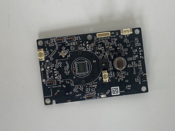

  13. Ring Stick Up Cam Battery Motherboard Replacement: crwdns2935265:013crwdnd2935265:01crwdnd2935265:02crwdne2935265:0 Ring Stick Up Cam Battery Motherboard Replacement: crwdns2935265:013crwdnd2935265:02crwdnd2935265:02crwdne2935265:0
    • Carefully insert the spudger underneath gold adhesive at the lower left-hand corner of the motherboard.
    • Gently remove the adhesive cover from the motherboard.
