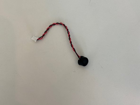

  18. Ring Stick Up Cam Battery Microphone Replacement, Microphone: crwdns2935265:018crwdnd2935265:01crwdnd2935265:01crwdne2935265:0
    • Remove the two 4 mm screws connecting the metal protective piece to the camera body using a Phillips #00 screwdriver.
  19. Ring Stick Up Cam Battery Microphone Replacement: crwdns2935265:019crwdnd2935265:01crwdnd2935265:01crwdne2935265:0
    • Using your fingers, carefully pinch the white connector attached to the black cable, and gently pull it out of its slot on the daughterboard.
  20. Ring Stick Up Cam Battery Microphone Replacement: crwdns2935265:020crwdnd2935265:01crwdnd2935265:01crwdne2935265:0
    • Rotate the camera body to a comfortable position.
    • Use the spudger to pry the metal component from the camera body.
    • The daughterboard and microphone should now be exposed.
  21. Ring Stick Up Cam Battery Microphone Replacement: crwdns2935265:021crwdnd2935265:01crwdnd2935265:01crwdne2935265:0
    • Gently remove the daughterboard from the base with your hands or the spudger if necessary.
  22. Ring Stick Up Cam Battery Microphone Replacement: crwdns2935265:022crwdnd2935265:01crwdnd2935265:02crwdne2935265:0 Ring Stick Up Cam Battery Microphone Replacement: crwdns2935265:022crwdnd2935265:02crwdnd2935265:02crwdne2935265:0
    Halberd Spudger
    $2.99
    • Use the hook end of the halberd spudger to carefully lift the microphone from the base.
