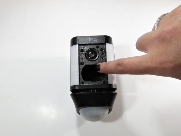

    • Lay Spotlight Cam Battery down.
  2. Ring Spotlight Cam Battery Speaker Replacement: crwdns2935265:02crwdnd2935265:01crwdnd2935265:01crwdne2935265:0
    • Using metal spudger, place under sound mat and pull upward.
  3. Ring Spotlight Cam Battery Speaker Replacement: crwdns2935265:03crwdnd2935265:01crwdnd2935265:01crwdne2935265:0
    • Remove piece by pulling upward.
  4. Ring Spotlight Cam Battery Speaker Replacement: crwdns2935265:04crwdnd2935265:01crwdnd2935265:02crwdne2935265:0 Ring Spotlight Cam Battery Speaker Replacement: crwdns2935265:04crwdnd2935265:02crwdnd2935265:02crwdne2935265:0
    • Press down on sound piece.
  5. Ring Spotlight Cam Battery Speaker Replacement: crwdns2935265:05crwdnd2935265:01crwdnd2935265:01crwdne2935265:0
    • Remove sound piece.
