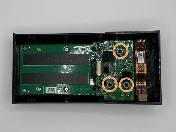

  8. Ring Outdoor Security Cam Speakers Replacement: crwdns2935265:08crwdnd2935265:01crwdnd2935265:02crwdne2935265:0 Ring Outdoor Security Cam Speakers Replacement: crwdns2935265:08crwdnd2935265:02crwdnd2935265:02crwdne2935265:0
    • Remove the silver 5vmm Phillips #00 screw, and the two 10mm Phillips #00 from the next circuit board.
    • Remove the 3 plastic spacers on the device.

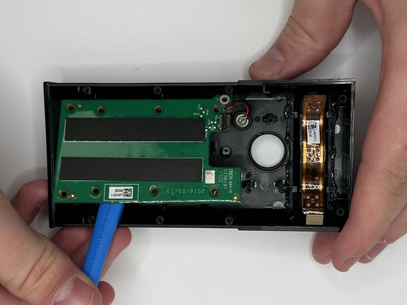

  9. Ring Outdoor Security Cam Speakers Replacement: crwdns2935265:09crwdnd2935265:01crwdnd2935265:03crwdne2935265:0 Ring Outdoor Security Cam Speakers Replacement: crwdns2935265:09crwdnd2935265:02crwdnd2935265:03crwdne2935265:0 Ring Outdoor Security Cam Speakers Replacement: crwdns2935265:09crwdnd2935265:03crwdnd2935265:03crwdne2935265:0
    • Pry the motherboard out with a plastic opening tool.

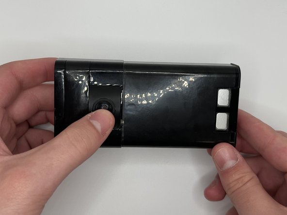

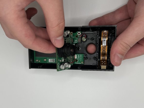

    • Flip the device over and then carefully press on the camera lens to remove the camera and the attached mother board from the device.
  10. Ring Outdoor Security Cam Speakers Replacement: crwdns2935265:010crwdnd2935265:01crwdnd2935265:02crwdne2935265:0 Ring Outdoor Security Cam Speakers Replacement: crwdns2935265:010crwdnd2935265:02crwdnd2935265:02crwdne2935265:0
    • Remove the six silver 4.5 mm Phillips #00 screws holding the daughterboard into the device.
    • Then use the plastic prying tool to remove the final daughterboard and attached microphone
  11. Ring Outdoor Security Cam Speakers Replacement: crwdns2935265:011crwdnd2935265:01crwdnd2935265:01crwdne2935265:0
    • Using the plastic prying tool pop out the speakers on the back of the daughterboard.
