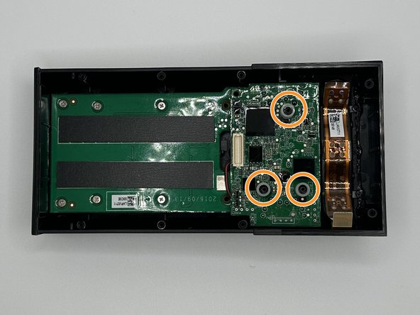

    • Remove the silver 5 mm Phillips #00 screw, and the two 10 mm Phillips #00 from the next motherboard.
    • Remove the 3 plastic spacers on the device.

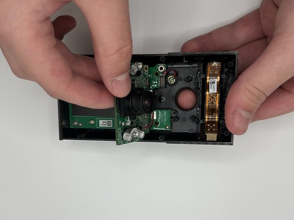

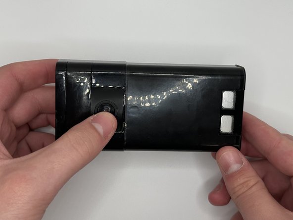

    • Pry the motherboard out with a plastic opening tool.
    • Flip the device over and then carefully press on the camera lens to remove the camera and the attached mother board from the device.
