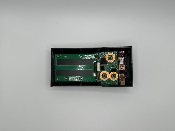

  8. Ring Outdoor Security Cam Camera Replacement: crwdns2935265:08crwdnd2935265:01crwdnd2935265:02crwdne2935265:0 Ring Outdoor Security Cam Camera Replacement: crwdns2935265:08crwdnd2935265:02crwdnd2935265:02crwdne2935265:0
    • Remove the silver 5 mm Phillips #00 screw, and the two 10 mm Phillips #00 from the next motherboard.
    • Then remove the three plastic spacers on the device.

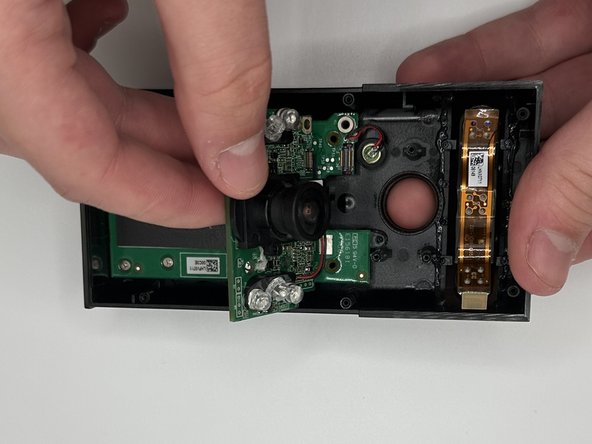

  9. Ring Outdoor Security Cam Camera Replacement: crwdns2935265:09crwdnd2935265:01crwdnd2935265:03crwdne2935265:0 Ring Outdoor Security Cam Camera Replacement: crwdns2935265:09crwdnd2935265:02crwdnd2935265:03crwdne2935265:0 Ring Outdoor Security Cam Camera Replacement: crwdns2935265:09crwdnd2935265:03crwdnd2935265:03crwdne2935265:0
    • Pry the motherboard out with a plastic opening tool.

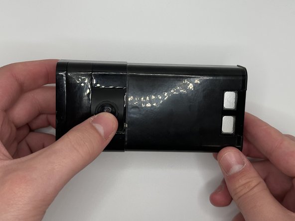

    • Flip the device over and then carefully press on the camera lens to remove the camera and the attached mother board from the device.
