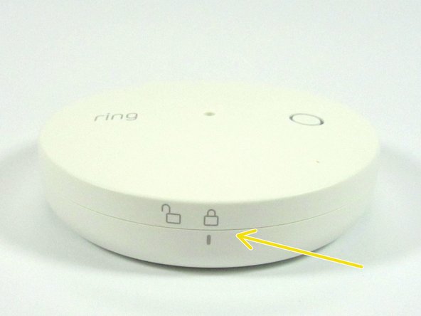

  3. Ring Glass Break Sensor Teardown: crwdns2935265:03crwdnd2935265:01crwdnd2935265:03crwdne2935265:0 Ring Glass Break Sensor Teardown: crwdns2935265:03crwdnd2935265:02crwdnd2935265:03crwdne2935265:0 Ring Glass Break Sensor Teardown: crwdns2935265:03crwdnd2935265:03crwdnd2935265:03crwdne2935265:0
    • Close up look at the Glass Break Sensor
    • Glass Break Sensor Microphone
    • Setup Button
    • Twist off bottom for access to the AA batteries
    • Pull Tab to enable the batteries to power the sensor

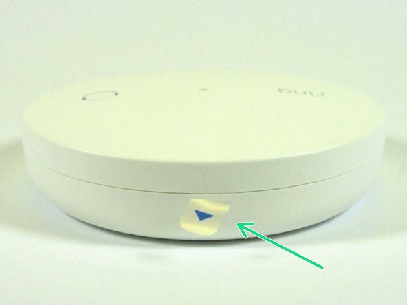

  5. Ring Glass Break Sensor Teardown: crwdns2935265:05crwdnd2935265:01crwdnd2935265:01crwdne2935265:0
    • Twisting off the bottom of the unit shows the removeable batteries.
    • It is nice to see a security product with easily accessible and replaceable batteries

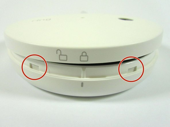

  6. Ring Glass Break Sensor Teardown: crwdns2935265:06crwdnd2935265:01crwdnd2935265:03crwdne2935265:0 Ring Glass Break Sensor Teardown: crwdns2935265:06crwdnd2935265:02crwdnd2935265:03crwdne2935265:0 Ring Glass Break Sensor Teardown: crwdns2935265:06crwdnd2935265:03crwdnd2935265:03crwdne2935265:0
    • Next, separate the top with a iFixit Opening Tool to get access to the electronics inside.
    • There are number of catches around the outside of the device. These catches popped loose fairly easily with the iFixit Opening Tool.
    • Once the top is removed, we get our first look at the internal PCB

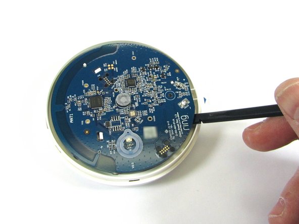

  7. Ring Glass Break Sensor Teardown: crwdns2935265:07crwdnd2935265:01crwdnd2935265:03crwdne2935265:0 Ring Glass Break Sensor Teardown: crwdns2935265:07crwdnd2935265:02crwdnd2935265:03crwdne2935265:0 Ring Glass Break Sensor Teardown: crwdns2935265:07crwdnd2935265:03crwdnd2935265:03crwdne2935265:0
    • There is a single Philips #0 screw holding the PCB to the enclosure.
    • Remove the single screw allows the Internal PCB to be pried out with a Spudger tool
    • Internal PCB removed from the enclosure

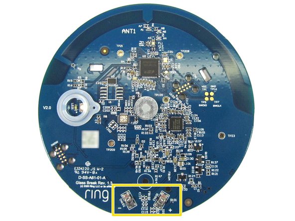

    • With the internal PCB removed, we get our first look at the backside and front sides of the PCB.
  10. Ring Glass Break Sensor Teardown: crwdns2935265:010crwdnd2935265:01crwdnd2935265:02crwdne2935265:0 Ring Glass Break Sensor Teardown: crwdns2935265:010crwdnd2935265:02crwdnd2935265:02crwdne2935265:0
    • Close up view of the backside of the PCB
    • MEMS Microphone, Vesper VM3011 - World's First Adaptive ZEROPOWER Listening™ Digital Piezoelectric MEMS Microphone
    • Close up view of the MEMS Microphone
    • Switch/button operation is not documented
    • Power Shutoff Switch. When the bottom is rotated to access the batteries - this switch slides as the enclosure bottom is rotated to shutoff battery power to the PCB

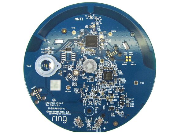

    • Close up view of the front side of the PCB
    • Setup button and environment protection gasket
    • Dust filter and protection cover for microphone port

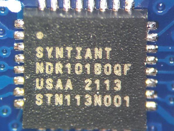

    • Close up view of some of the electrical components on the top side of the PCB. Other than the two large ICs on the topside of the PCB, the other components look to be related to power management and control
    • Syntiant, NDR101BQQF. Always-on Neural Processor. Used for detecting the breaking glass
    • Silicon Labs, RZ13M1442. Z-Wave Long Range Radio with ARM MCU
