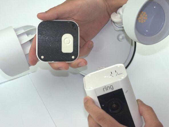

Ring Floodlight Cam Camera Module Replacement
    1. Ring Floodlight Cam Camera Module Replacement, Motherboard: crwdns2935265:01crwdnd2935265:01crwdnd2935265:02crwdne2935265:0 Ring Floodlight Cam Camera Module Replacement, Motherboard: crwdns2935265:01crwdnd2935265:02crwdnd2935265:02crwdne2935265:0
      • Remove the external cover with a Jimmy tool.
    2. Ring Floodlight Cam Camera Module Replacement: crwdns2935265:02crwdnd2935265:01crwdnd2935265:02crwdne2935265:0 Ring Floodlight Cam Camera Module Replacement: crwdns2935265:02crwdnd2935265:02crwdnd2935265:02crwdne2935265:0
      • Remove the four outer cover 4.5mm screws with a Philips 1 screwdriver.
    3. Ring Floodlight Cam Camera Module Replacement: crwdns2935265:03crwdnd2935265:01crwdnd2935265:01crwdne2935265:0
      • Remove the internal cover.
    4. Ring Floodlight Cam Camera Module Replacement: crwdns2935265:04crwdnd2935265:01crwdnd2935265:01crwdne2935265:0
      • Disconnect the flexible flat cable (FFC) from the motherboard.
    5. Ring Floodlight Cam Camera Module Replacement: crwdns2935265:05crwdnd2935265:01crwdnd2935265:01crwdne2935265:0
      • Remove the three-prong connector with angled tweezers.
    6. Ring Floodlight Cam Camera Module Replacement: crwdns2935265:06crwdnd2935265:01crwdnd2935265:01crwdne2935265:0
      • Remove the 2mm screws with a Phillips #00 screwdriver.
    7. Ring Floodlight Cam Camera Module Replacement: crwdns2935265:07crwdnd2935265:01crwdnd2935265:02crwdne2935265:0 Ring Floodlight Cam Camera Module Replacement: crwdns2935265:07crwdnd2935265:02crwdnd2935265:02crwdne2935265:0
      • Remove the power supply.
      • Disconnect the power supply from the device.
    8. Ring Floodlight Cam Camera Module Replacement: crwdns2935265:08crwdnd2935265:01crwdnd2935265:01crwdne2935265:0
      • Remove the 2mm screws with a Phillips 00 screwdriver from the base connector.
      • From this step forward use a low profile wrench instead of a screwdriver with the correct bit size to remove screws non-destructively.
    9. Ring Floodlight Cam Camera Module Replacement: crwdns2935265:09crwdnd2935265:01crwdnd2935265:02crwdne2935265:0 Ring Floodlight Cam Camera Module Replacement: crwdns2935265:09crwdnd2935265:02crwdnd2935265:02crwdne2935265:0
      • Drill holes into the exterior with a 1/16 drill bit.
      • Skip this step unless you lack the specialized tools or other attempts to remove screws non destructively were unsuccessful.
    10. Ring Floodlight Cam Camera Module Replacement: crwdns2935265:010crwdnd2935265:01crwdnd2935265:01crwdne2935265:0
      • Unscrew the 2mm screws on the metal baseplate with a Phillips 00 screwdriver.
    11. Ring Floodlight Cam Camera Module Replacement: crwdns2935265:011crwdnd2935265:01crwdnd2935265:01crwdne2935265:0
      • Remove the metal baseplate.
    12. Ring Floodlight Cam Camera Module Replacement: crwdns2935265:012crwdnd2935265:01crwdnd2935265:01crwdne2935265:0
      • Remove the power connector from the motherboard using angled tweezers.
    13. Ring Floodlight Cam Camera Module Replacement: crwdns2935265:013crwdnd2935265:01crwdnd2935265:01crwdne2935265:0
      • Remove the front-end flexible flat cable (FFC) with angled tweezers.
    14. Ring Floodlight Cam Camera Module Replacement: crwdns2935265:014crwdnd2935265:01crwdnd2935265:01crwdne2935265:0
      • Remove the motion sensor flat flexible cable (FFC).
    15. Ring Floodlight Cam Camera Module Replacement: crwdns2935265:015crwdnd2935265:01crwdnd2935265:02crwdne2935265:0 Ring Floodlight Cam Camera Module Replacement: crwdns2935265:015crwdnd2935265:02crwdnd2935265:02crwdne2935265:0
      • Remove the motherboard module.
    1. Ring Floodlight Cam Camera Module Replacement, Camera Module: crwdns2935265:016crwdnd2935265:01crwdnd2935265:01crwdne2935265:0
      • Drill holes with a 1/16 drill bit.
    2. Ring Floodlight Cam Camera Module Replacement: crwdns2935265:017crwdnd2935265:01crwdnd2935265:02crwdne2935265:0 Ring Floodlight Cam Camera Module Replacement: crwdns2935265:017crwdnd2935265:02crwdnd2935265:02crwdne2935265:0
      • Remove the 2mm screws with an iFixit PH00 screwdriver.
    3. Ring Floodlight Cam Camera Module Replacement: crwdns2935265:018crwdnd2935265:01crwdnd2935265:01crwdne2935265:0
      • Peel the copper strip from camera module.
    4. Ring Floodlight Cam Camera Module Replacement: crwdns2935265:019crwdnd2935265:01crwdnd2935265:02crwdne2935265:0 Ring Floodlight Cam Camera Module Replacement: crwdns2935265:019crwdnd2935265:02crwdnd2935265:02crwdne2935265:0
      • Unplug the WiFi antenna cables with angled tweezers.
    5. Ring Floodlight Cam Camera Module Replacement: crwdns2935265:020crwdnd2935265:01crwdnd2935265:02crwdne2935265:0 Ring Floodlight Cam Camera Module Replacement: crwdns2935265:020crwdnd2935265:02crwdnd2935265:02crwdne2935265:0
      • Remove 2mm screws with a PH00 screwdriver.
    6. Ring Floodlight Cam Camera Module Replacement: crwdns2935265:021crwdnd2935265:01crwdnd2935265:01crwdne2935265:0
      • Remove the 3 pin power connector from the camera module.
    7. Ring Floodlight Cam Camera Module Replacement: crwdns2935265:022crwdnd2935265:01crwdnd2935265:03crwdne2935265:0 Ring Floodlight Cam Camera Module Replacement: crwdns2935265:022crwdnd2935265:02crwdnd2935265:03crwdne2935265:0 Ring Floodlight Cam Camera Module Replacement: crwdns2935265:022crwdnd2935265:03crwdnd2935265:03crwdne2935265:0
      • Remove the camera module.
To reassemble your device, follow these instructions in reverse order and before inserting power supply fill the drill holes with plastic putty.
