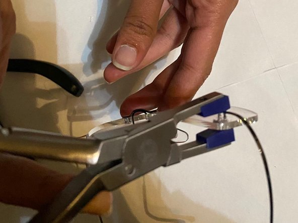

    • Take the compression sleeves and insert them into the outer lens holes with the pins facing out.
  2. Rimless Glasses Temple Replacement: crwdns2935265:02crwdnd2935265:01crwdnd2935265:02crwdne2935265:0 Rimless Glasses Temple Replacement: crwdns2935265:02crwdnd2935265:02crwdnd2935265:02crwdne2935265:0
    • Using the cutting head of the glasses plier, trim the compression sleeve pins down so that only 1 mm remains sticking out the front of the glasses.
    • Take a push pin and enlarge the holes of compression sleeves by gently inserting the pin into the holes.
  3. Rimless Glasses Temple Replacement: crwdns2935265:03crwdnd2935265:01crwdnd2935265:03crwdne2935265:0 Rimless Glasses Temple Replacement: crwdns2935265:03crwdnd2935265:02crwdnd2935265:03crwdne2935265:0 Rimless Glasses Temple Replacement: crwdns2935265:03crwdnd2935265:03crwdnd2935265:03crwdne2935265:0
    • Insert the arm of the glasses into the enlarged holes of the compression sleeves.
    • Use a silhousette to gently press the arm from the top and tighten it to the glasses.

This is very good if the frame arm just fell off of the lens, but it doesn't tell how to remove a broken frame arm from the lens—ie, how to get the compression sleeve off of the broken arm without damaging the lens.
