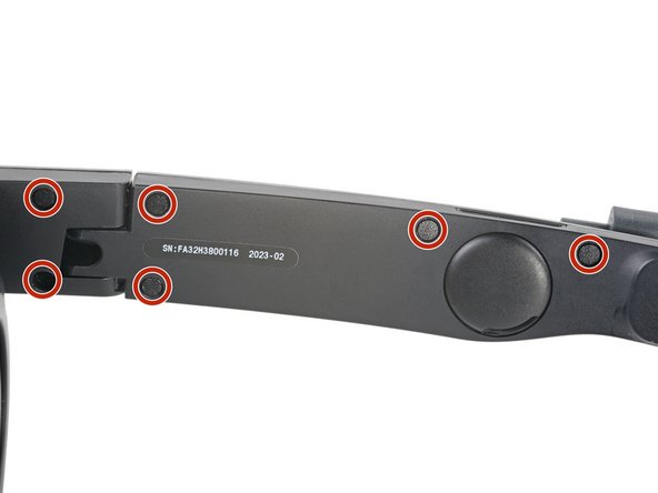

  1. Right Temple, Remove the screw covers: crwdns2935265:01crwdnd2935265:01crwdnd2935265:02crwdne2935265:0 Right Temple, Remove the screw covers: crwdns2935265:01crwdnd2935265:02crwdnd2935265:02crwdne2935265:0
    • Use tweezers to remove the six screw covers from the right temple.
