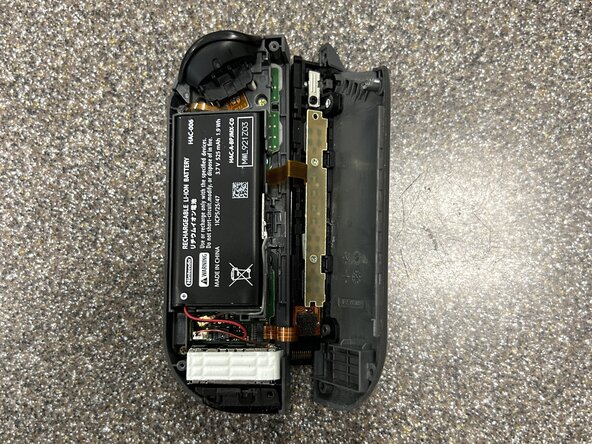

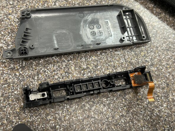

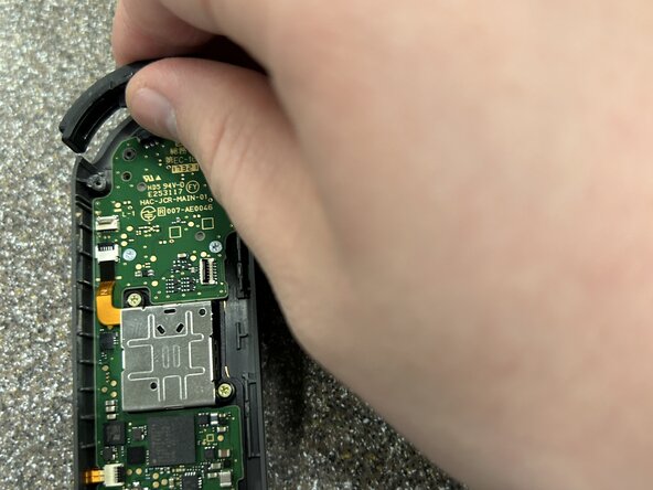

    • To separate the shell halves there are two options:
    • 1. Use an opening pick and insert it between the IR sensor and the other half carefully prying them apart
    • 2. Push up on the rail towards the shell halve not attached to the IR sensor
    • With the shell halves separated, carefully put the side with the rail next to the other half
    • There are two ribbon cables connecting the half with the rail to the other side

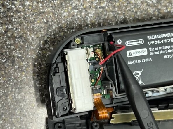

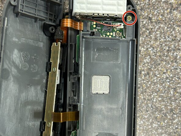

  3. Right Joy-Con Teardown: crwdns2935265:03crwdnd2935265:01crwdnd2935265:02crwdne2935265:0 Right Joy-Con Teardown: crwdns2935265:03crwdnd2935265:02crwdnd2935265:02crwdne2935265:0
    • Next, carefully disconnect the battery from the joycon using the spudger
  4. Right Joy-Con Teardown: crwdns2935265:04crwdnd2935265:01crwdnd2935265:03crwdne2935265:0 Right Joy-Con Teardown: crwdns2935265:04crwdnd2935265:02crwdnd2935265:03crwdne2935265:0 Right Joy-Con Teardown: crwdns2935265:04crwdnd2935265:03crwdnd2935265:03crwdne2935265:0

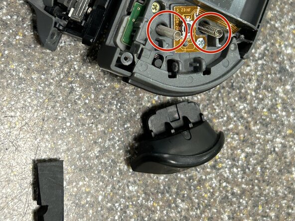

    • Insert the flat side of the spudger or the opening pick between the ZR button and the upper bracket. Lift up on the ZR button until the clips disengage and you can carefully remove it.
    • There are springs beneath the ZR trigger. Make sure to disengage the clips and remove the button carefully and slowly as the two marked springs will want to fly out
  7. Right Joy-Con Teardown: crwdns2935265:07crwdnd2935265:01crwdnd2935265:02crwdne2935265:0 Right Joy-Con Teardown: crwdns2935265:07crwdnd2935265:02crwdnd2935265:02crwdne2935265:0
    • Carefully remove the two springs

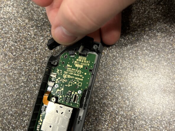

  9. Right Joy-Con Teardown: crwdns2935265:09crwdnd2935265:01crwdnd2935265:03crwdne2935265:0 Right Joy-Con Teardown: crwdns2935265:09crwdnd2935265:02crwdnd2935265:03crwdne2935265:0 Right Joy-Con Teardown: crwdns2935265:09crwdnd2935265:03crwdnd2935265:03crwdne2935265:0
    • Remove the three Phillips PH000 screws holding down the upper bracket and pull the bracket off the motherboard
    • Make sure not to hurt the free ZR trigger button flex cable as you pull up the bracket
  10. Right Joy-Con Teardown: crwdns2935265:010crwdnd2935265:01crwdnd2935265:03crwdne2935265:0 Right Joy-Con Teardown: crwdns2935265:010crwdnd2935265:02crwdnd2935265:03crwdne2935265:0 Right Joy-Con Teardown: crwdns2935265:010crwdnd2935265:03crwdnd2935265:03crwdne2935265:0
    • Flip up the ZIF connector lock holding in the ZR trigger button cable with the tip of the spudger and remove the flex cable

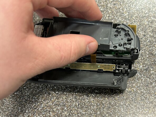

    • Flip up the ZIF connector locks holding in the rail ribbon cables and remove the flex cables
  12. Right Joy-Con Teardown: crwdns2935265:012crwdnd2935265:01crwdnd2935265:03crwdne2935265:0 Right Joy-Con Teardown: crwdns2935265:012crwdnd2935265:02crwdnd2935265:03crwdne2935265:0 Right Joy-Con Teardown: crwdns2935265:012crwdnd2935265:03crwdnd2935265:03crwdne2935265:0

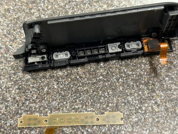

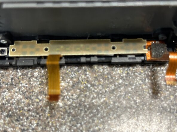

    • Working on the charging rail, remove the two Phillips PH000 screws holding down the buttons
    • Though there are three holes on the joy con rail, only two are used for screws
  13. Right Joy-Con Teardown: crwdns2935265:013crwdnd2935265:01crwdnd2935265:02crwdne2935265:0 Right Joy-Con Teardown: crwdns2935265:013crwdnd2935265:02crwdnd2935265:02crwdne2935265:0
    • Remove the rubber button backings and the plastic buttons
  14. Right Joy-Con Teardown: crwdns2935265:014crwdnd2935265:01crwdnd2935265:02crwdne2935265:0 Right Joy-Con Teardown: crwdns2935265:014crwdnd2935265:02crwdnd2935265:02crwdne2935265:0
    • Remove the Phillips PH000 screw holding the rail to the back shell
  15. Right Joy-Con Teardown: crwdns2935265:015crwdnd2935265:01crwdnd2935265:02crwdne2935265:0 Right Joy-Con Teardown: crwdns2935265:015crwdnd2935265:02crwdnd2935265:02crwdne2935265:0
    • Remove the last Phillips PH000 screw in the rail holding down the buckle lock
    • While I was unable to remove my buckle lock successfully, there is an official iFixit guide for removing it worth checking out:
    • Joy-Con Buckle Lock Replacement
  16. Right Joy-Con Teardown: crwdns2935265:016crwdnd2935265:01crwdnd2935265:02crwdne2935265:0 Right Joy-Con Teardown: crwdns2935265:016crwdnd2935265:02crwdnd2935265:02crwdne2935265:0

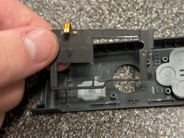

    • Concluding our time with the rail, remove the lock button from the shell
  17. Right Joy-Con Teardown: crwdns2935265:017crwdnd2935265:01crwdnd2935265:03crwdne2935265:0 Right Joy-Con Teardown: crwdns2935265:017crwdnd2935265:02crwdnd2935265:03crwdne2935265:0 Right Joy-Con Teardown: crwdns2935265:017crwdnd2935265:03crwdnd2935265:03crwdne2935265:0

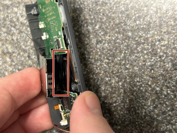

    • Remove the joystick carefully
    • Do not pull out the joystick quickly or with extreme force! There is a liner underneath the joystick that it will likely get caught on which protects the internals from dust and debris. Wiggle out the joystick carefully lining up the joystick center to the liner and using light force
  21. Right Joy-Con Teardown: crwdns2935265:021crwdnd2935265:01crwdnd2935265:03crwdne2935265:0 Right Joy-Con Teardown: crwdns2935265:021crwdnd2935265:02crwdnd2935265:03crwdne2935265:0 Right Joy-Con Teardown: crwdns2935265:021crwdnd2935265:03crwdnd2935265:03crwdne2935265:0
    • Carefully remove the joystick liner by pulling up on it with tweezers and lightly pulling on the sections adhered to the upper chassis
    • One of the adhered sections is under the motherboard of this controller so be patient removing the liner
    • Note for reassembly: Try reattaching this when the mainboard is not connected as it it difficult to get one of the adhered sections under the mainboard

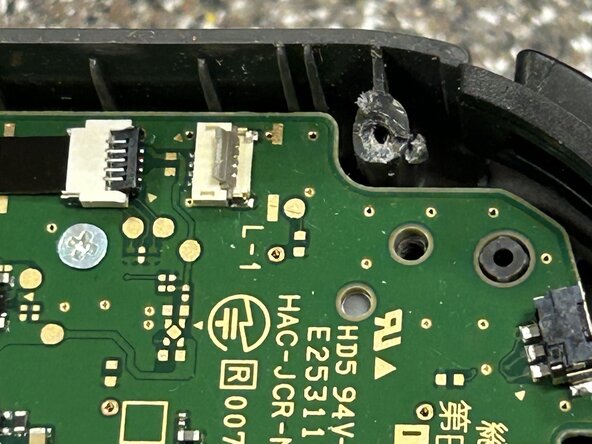

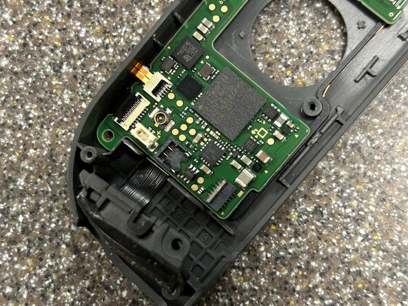

  22. Right Joy-Con Teardown: crwdns2935265:022crwdnd2935265:01crwdnd2935265:02crwdne2935265:0 Right Joy-Con Teardown: crwdns2935265:022crwdnd2935265:02crwdnd2935265:02crwdne2935265:0

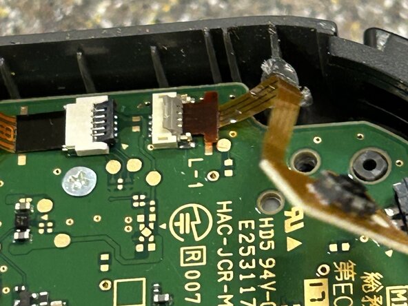

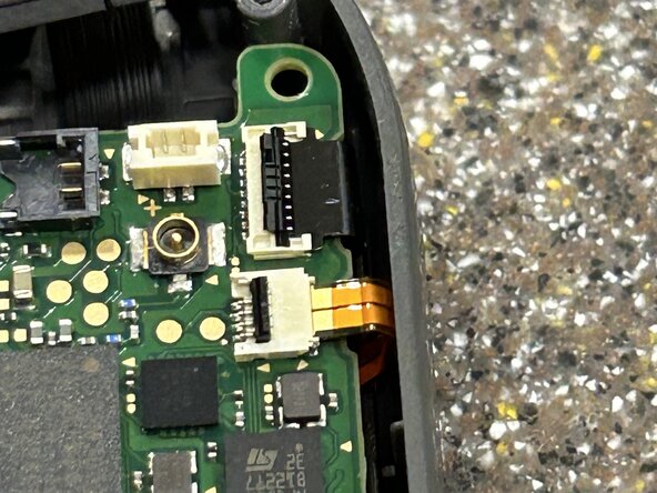

    • Flip up one of the ZIF connectors (I will not be responding to messages at this time regarding the allegation I forgot to disconnect the second cable until later on)
    • Note for reassembly: These two ZIF connectors should be connected before screwing back in the mainboard as it is a royal pain to line up the cables and connectors when screwed on
  23. Right Joy-Con Teardown: crwdns2935265:023crwdnd2935265:01crwdnd2935265:03crwdne2935265:0 Right Joy-Con Teardown: crwdns2935265:023crwdnd2935265:02crwdnd2935265:03crwdne2935265:0 Right Joy-Con Teardown: crwdns2935265:023crwdnd2935265:03crwdnd2935265:03crwdne2935265:0

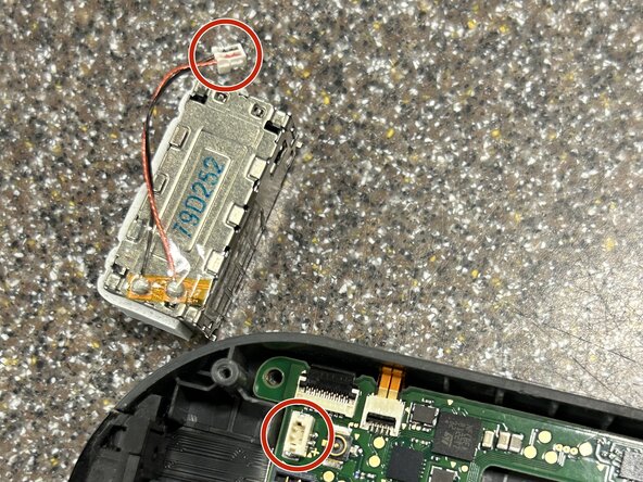

    • Remove the rumble pack by prying up on the corner next to where the rail once was with a spudger. Once out of its socket, use tweezers to pull the cable connector out of the socket. It is inserted quite firmly so be careful not to hurt the cable and use your fingernails if needed
    • There is some mild adhesive holding down the rumble pack so take care not to damage the rumble pack. Additionally, do not remove it fast enough to hurt one of its connecting cables if it suddenly breaks free

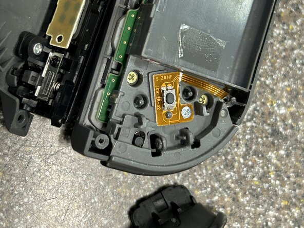

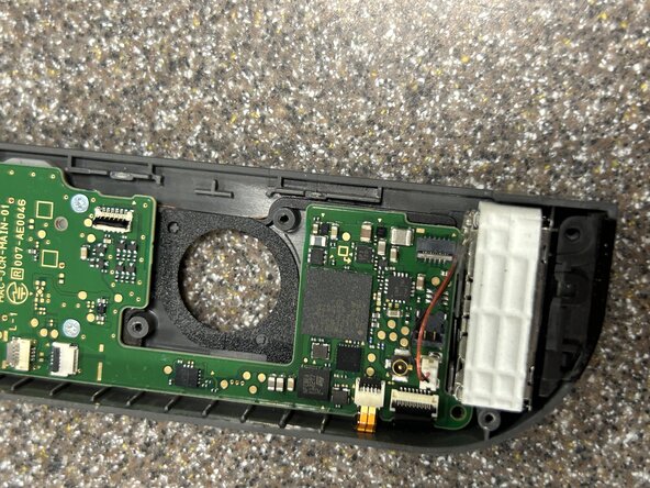

    • Carefully pull the IR sensor out of its socket making sure not to tear the ribbon cable connected to its button
  25. Right Joy-Con Teardown: crwdns2935265:025crwdnd2935265:01crwdnd2935265:01crwdne2935265:0

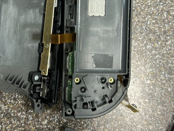

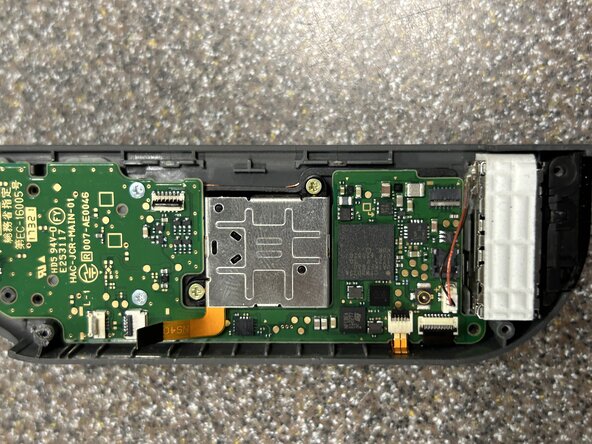

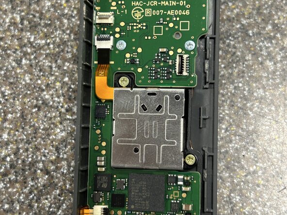

    • Remove the final two Phillips PH000 holding down the motherboard
  26. Right Joy-Con Teardown: crwdns2935265:026crwdnd2935265:01crwdnd2935265:02crwdne2935265:0 Right Joy-Con Teardown: crwdns2935265:026crwdnd2935265:02crwdnd2935265:02crwdne2935265:0
    • Flip the final ZIF connector, detach both cables, and remove the motherboard (again, as I mentioned in step 22, I am not responding to any allegations regarding forgetting to flip this ZIF cable earlier)
  27. Right Joy-Con Teardown: crwdns2935265:027crwdnd2935265:01crwdnd2935265:02crwdne2935265:0 Right Joy-Con Teardown: crwdns2935265:027crwdnd2935265:02crwdnd2935265:02crwdne2935265:0

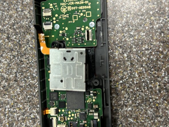

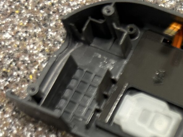

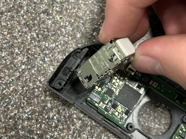

    • Carefully remove the IR sensor
    • The ribbon cable is lightly adhered to the chassis of the controller so make sure not to use excessive force or tear it
  28. Right Joy-Con Teardown: crwdns2935265:028crwdnd2935265:01crwdnd2935265:02crwdne2935265:0 Right Joy-Con Teardown: crwdns2935265:028crwdnd2935265:02crwdnd2935265:02crwdne2935265:0
    • Remove the adhered NFC reader by prying up on an edge carefully and pulling up on other areas until it can be safely removed (marked is the corner I pulled up from)
    • The wires on the NFC reader (while insulated) are not protected from poor attempts to lift up this piece. Use your eyes, good judgement, and great care not to damage this component

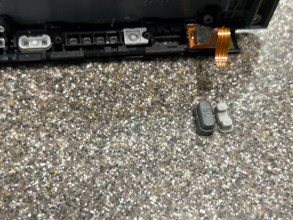

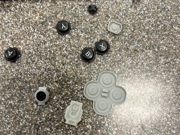

    • Complete this teardown by removing the buttons and their rubber covers
