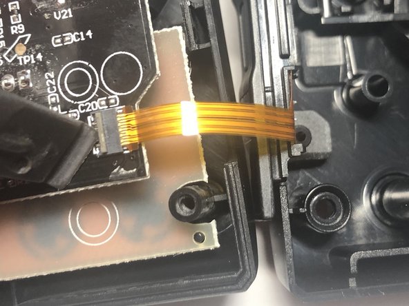

    2. Right Controller, Open controller halves: crwdns2935265:02crwdnd2935265:01crwdnd2935265:01crwdne2935265:0
      • Warning: The two halves easily come apart, but the small ribbon cable between them can easily be damaged.
      • Lift the back half slightly off the front half and fold it open along the right edge.
      • The ribbon cable is circled in the image.

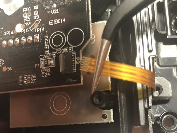

    3. Right Controller, Disconnect ribbon cable: crwdns2935265:03crwdnd2935265:01crwdnd2935265:03crwdne2935265:0 Right Controller, Disconnect ribbon cable: crwdns2935265:03crwdnd2935265:02crwdnd2935265:03crwdne2935265:0 Right Controller, Disconnect ribbon cable: crwdns2935265:03crwdnd2935265:03crwdnd2935265:03crwdne2935265:0
      • Use a plastic spudger to flip the ribbon cable latch up as shown in the first two images.
      • Remove the ribbon cable from the slot by pulling to the right with tweezers or fingers gently.

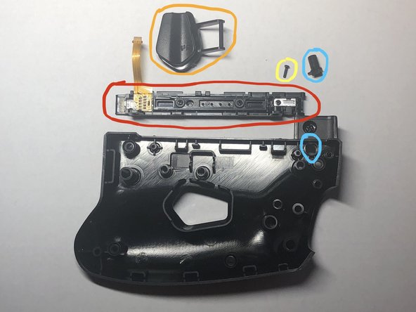

    4. Right Controller, Disassemble back half: crwdns2935265:04crwdnd2935265:01crwdnd2935265:02crwdne2935265:0 Right Controller, Disassemble back half: crwdns2935265:04crwdnd2935265:02crwdnd2935265:02crwdne2935265:0
      • Remove one PH00 screw that is securing the rail to the back half.
      • The FR button can be removed by placing a lever/spudger under the circled area.
      • The rail connector can be removed once the yellow circled screw is removed.
      • The button that releases the buckle lock can be removed after the rail and goes in the hole circled on the back half of the controller.
      • The one remaining screw (not marked) does not need to be removed as it only secures a bit of plastic.

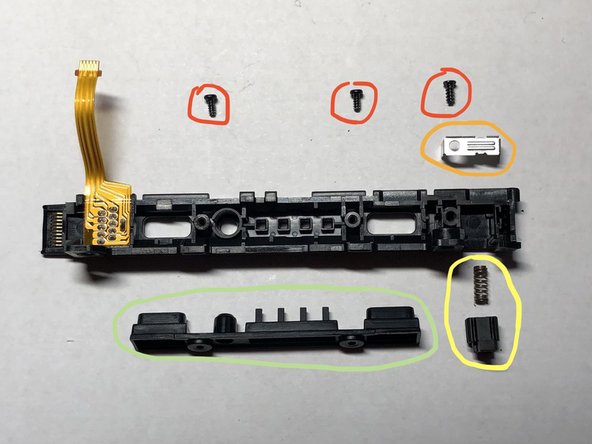

    5. Right Controller, Disassemble Rail: crwdns2935265:05crwdnd2935265:01crwdnd2935265:02crwdne2935265:0 Right Controller, Disassemble Rail: crwdns2935265:05crwdnd2935265:02crwdnd2935265:02crwdne2935265:0
      • Remove the three PH00 screws.
      • Pry out the metal cover over the buckle lock. Be gentle so as not to bend the metal.
      • The spring loaded buckle lock can then be removed. NOTE: Do not lose the spring when disassembling. Reassembly can be tricky because the spring needs to be compressed to get back in place.
      • The plastic cover over the holes in the middle of the rail can be removed. This is where the SL, SR, and connect buttons would be on a normal Joy Con controller and also the lights indicating which controller number it is.

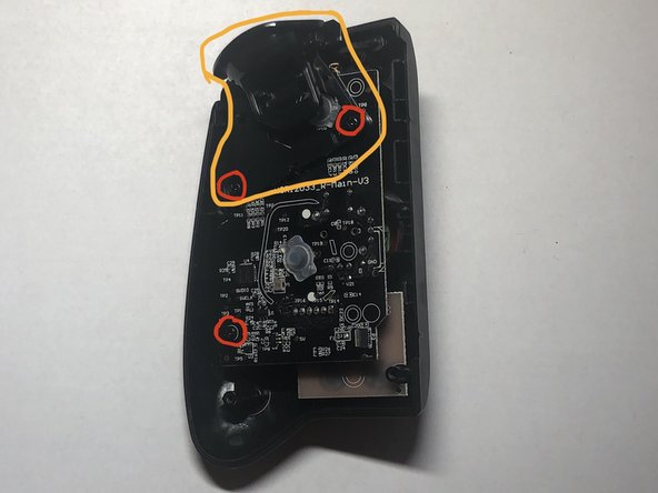

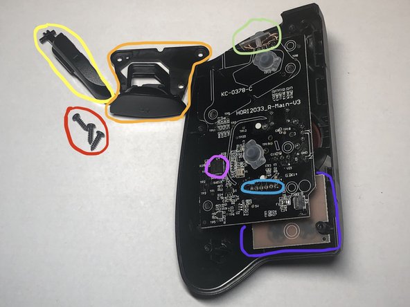

    6. Right Controller, Front Half - ZR & R buttons: crwdns2935265:06crwdnd2935265:01crwdnd2935265:03crwdne2935265:0 Right Controller, Front Half - ZR & R buttons: crwdns2935265:06crwdnd2935265:02crwdnd2935265:03crwdne2935265:0 Right Controller, Front Half - ZR & R buttons: crwdns2935265:06crwdnd2935265:03crwdnd2935265:03crwdne2935265:0
      • The ZR button can be removed once the red circled screws are removed.
      • The R button is underneath the ZR button and is easily removed once the ZR button is out of the way. There is a small hole that one end of the R button fits into.

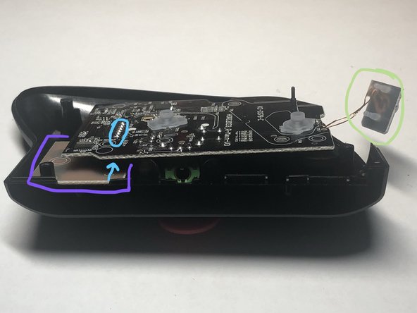

      • Remove three PH0 screws, two that hold the ZR button plastics and one on the top main board.

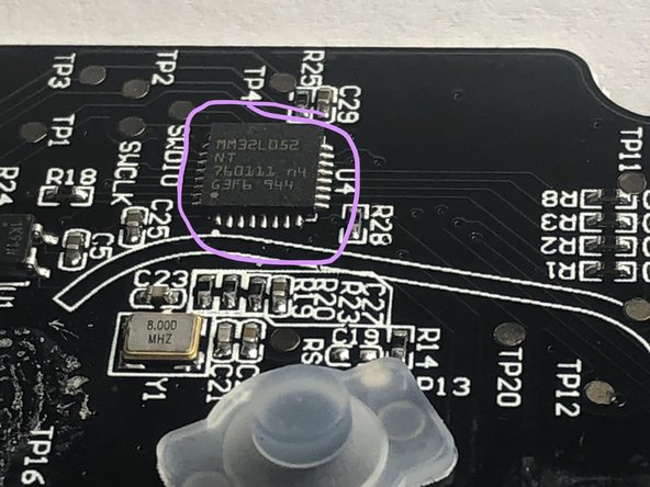

      • The processor for the controller can be seen on the top main board. See the details in Step 9??
      • The connector between the top and bottom boards is shown here.
      • The bottom board on the right controller is small and only picks up the bottom three buttons which using a small 6 pin connector.
      • Warning: Do not try to remove the top main board before you remove this small button board in the next step.

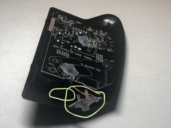

    7. Right Controller, Small R button board: crwdns2935265:07crwdnd2935265:01crwdnd2935265:03crwdne2935265:0 Right Controller, Small R button board: crwdns2935265:07crwdnd2935265:02crwdnd2935265:03crwdne2935265:0 Right Controller, Small R button board: crwdns2935265:07crwdnd2935265:03crwdnd2935265:03crwdne2935265:0
      • The small R button board is slid into a slot and has delicate wires that connect it to the top main board.
      • Clasp on both sides of the small R button board with your fingers and wiggle it out.
      • The top main board is connected to the bottom board with a connector.
      • The bottom board is small and underneath the top main board.

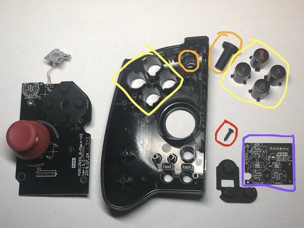

    8. Right Controller, Top main and bottom boards: crwdns2935265:08crwdnd2935265:01crwdnd2935265:03crwdne2935265:0 Right Controller, Top main and bottom boards: crwdns2935265:08crwdnd2935265:02crwdnd2935265:03crwdne2935265:0 Right Controller, Top main and bottom boards: crwdns2935265:08crwdnd2935265:03crwdnd2935265:03crwdne2935265:0
      • Pull straight up on the top main board and the two boards will disconnect. The connection between them is circled in light-blue. Notice the joystick controller is on the top main board.
      • The bottom board is still secured with one screw.
      • Remove one PH0 screw.
      • Remove the plus (+) button.
      • Remove the X, A, B, & Y buttons.
      • The bottom board can be removed as well as the last rubberized bottom three buttons.
      • Notice that this top main board has the same processor as the main motherboard of the left controller. It is MM32L052NT which is a ARM Cortex(TM) M0.

Hey there, thanks for having this guide made. I had an issue with the locking button not pushing in and Hori took 3 months to do nothing so I decided to see if I could fix it myself but because this guide was made I didn’t need to go in blind. Now it’s working and I can lock the controller into my Switch properly! Thanks again!

What is the best method to reattach the ribbon cable in step 3 during reassembly?
Derek Orzel - crwdns2934203:0crwdne2934203:0 crwdns2950251:0crwdne2950251:0
Lay the two halves next to each other, lift the locking bar on the board-side connector, use tweezers to hold the cable (like in pic 3 of Step 3), insert the end of the cable into into the board-side connecter (make sure to insert it all of the way), then lower the locking bar.
