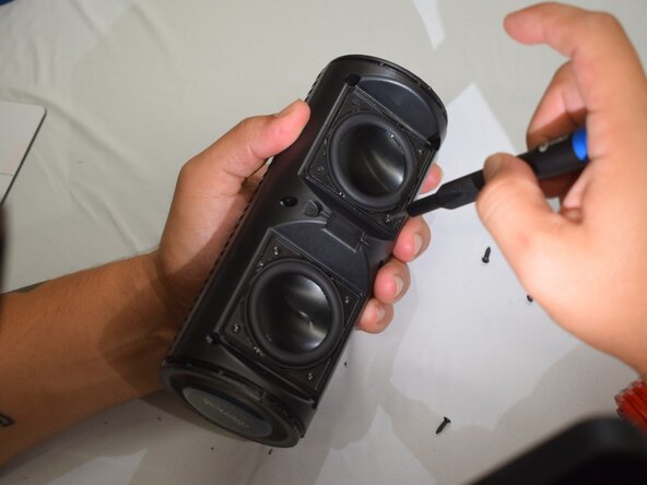

  11. Rienok S1 Mini Speaker Drivers Replacement, Speaker Drivers: crwdns2935265:011crwdnd2935265:01crwdnd2935265:02crwdne2935265:0 Rienok S1 Mini Speaker Drivers Replacement, Speaker Drivers: crwdns2935265:011crwdnd2935265:02crwdnd2935265:02crwdne2935265:0
    • Remove eight 8 mm screws from the speaker drivers using a Phillips #000 screwdriver.
  12. Rienok S1 Mini Speaker Drivers Replacement: crwdns2935265:012crwdnd2935265:01crwdnd2935265:01crwdne2935265:0
    • Desolder the two wires where they meet the speaker driver.
    • Solder the new speaker driver onto the wires.
