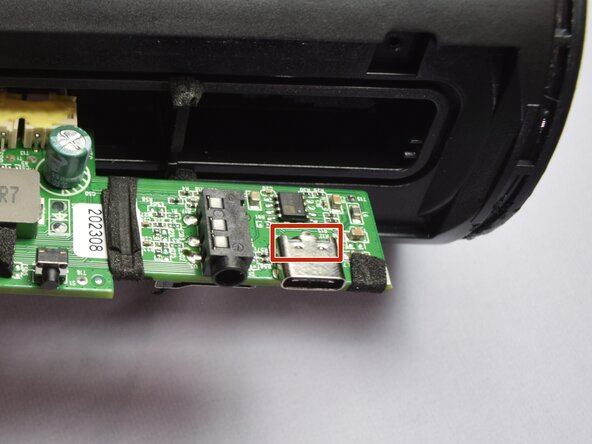

  11. Rienok S1 Mini Charging Port Replacement, Charging Port: crwdns2935265:011crwdnd2935265:01crwdnd2935265:02crwdne2935265:0 Rienok S1 Mini Charging Port Replacement, Charging Port: crwdns2935265:011crwdnd2935265:02crwdnd2935265:02crwdne2935265:0

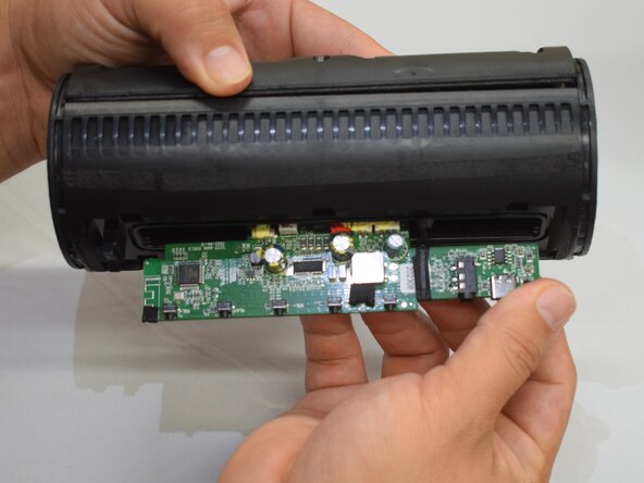

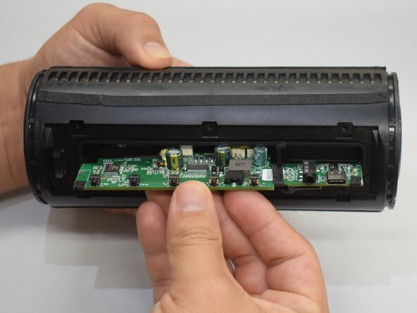

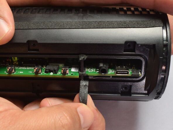

    • Instructions provided are without fully removing the motherboard. If that optional step was taken, there will be more freedom in taking these same steps.
    • Grasp the rubber stop and lightly pull down to allow the motherboard to be removed.
  12. Rienok S1 Mini Charging Port Replacement: crwdns2935265:012crwdnd2935265:01crwdnd2935265:03crwdne2935265:0 Rienok S1 Mini Charging Port Replacement: crwdns2935265:012crwdnd2935265:02crwdnd2935265:03crwdne2935265:0 Rienok S1 Mini Charging Port Replacement: crwdns2935265:012crwdnd2935265:03crwdnd2935265:03crwdne2935265:0

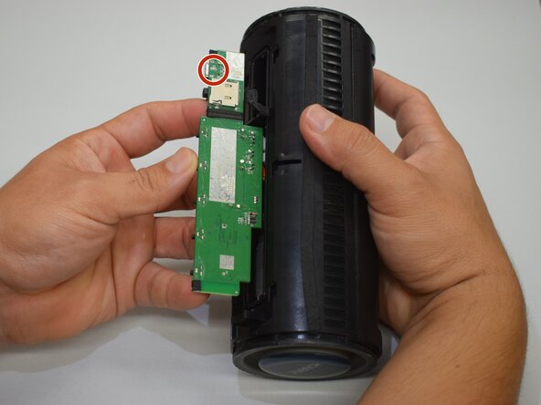

    • Grasp the motherboard and lightly wiggle the motherboard out until the point you see here.
  13. Rienok S1 Mini Charging Port Replacement: crwdns2935265:013crwdnd2935265:01crwdnd2935265:02crwdne2935265:0 Rienok S1 Mini Charging Port Replacement: crwdns2935265:013crwdnd2935265:02crwdnd2935265:02crwdne2935265:0
    • The charging port can be located here.
    • Prop the case so that the top side of the motherboard is facing you, and prepare the space for soldering.

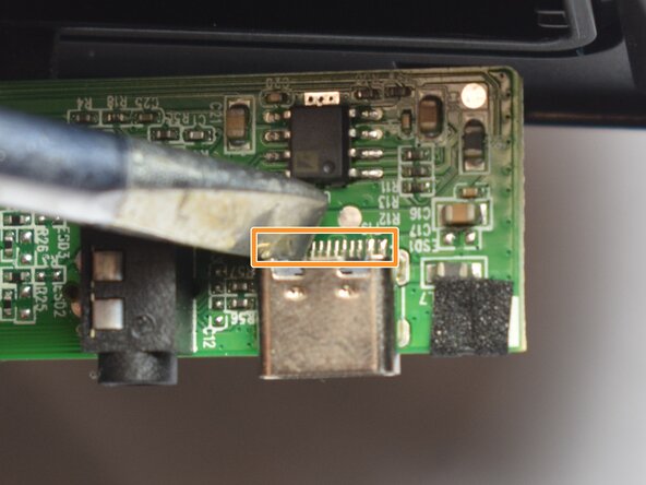

  14. Rienok S1 Mini Charging Port Replacement: crwdns2935265:014crwdnd2935265:01crwdnd2935265:03crwdne2935265:0 Rienok S1 Mini Charging Port Replacement: crwdns2935265:014crwdnd2935265:02crwdnd2935265:03crwdne2935265:0 Rienok S1 Mini Charging Port Replacement: crwdns2935265:014crwdnd2935265:03crwdnd2935265:03crwdne2935265:0

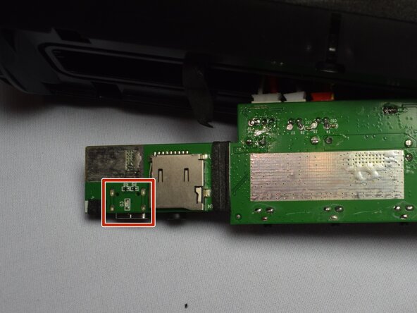

    • Locate the charging port on top of the motherboard, and look at the back end of it for a row of contacts.
    • Desolder this row of contacts that directs power into the motherboard, ensuring all solder is off the contacts.
    • Flip and prop the motherboard up with the bottom side facing you.
    • Information on how to solder and de-solder components can be found here.
    • Many small components are soldered just next to the contacts to be removed; touching these with the soldering iron could damage the motherboard or components.
  15. Rienok S1 Mini Charging Port Replacement: crwdns2935265:015crwdnd2935265:01crwdnd2935265:03crwdne2935265:0 Rienok S1 Mini Charging Port Replacement: crwdns2935265:015crwdnd2935265:02crwdnd2935265:03crwdne2935265:0 Rienok S1 Mini Charging Port Replacement: crwdns2935265:015crwdnd2935265:03crwdnd2935265:03crwdne2935265:0

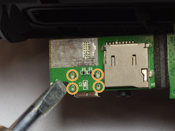

    • The charging port can be located on the underside of the motherboard here.
    • Desolder the four connections that connect the charging port to the motherboard.
    • Resolder the new charging port in the same locations.
