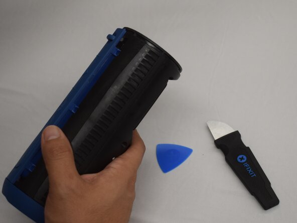

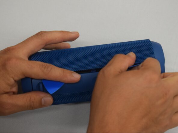

    • Start with the buttons panel up and facing you.
    • Wedge in one iFixit opening pick, and apply outward pressure to pop out one side of the grille.
    • Using a second pick, slide from the first pick towards the opposite end until one whole side is popped out.

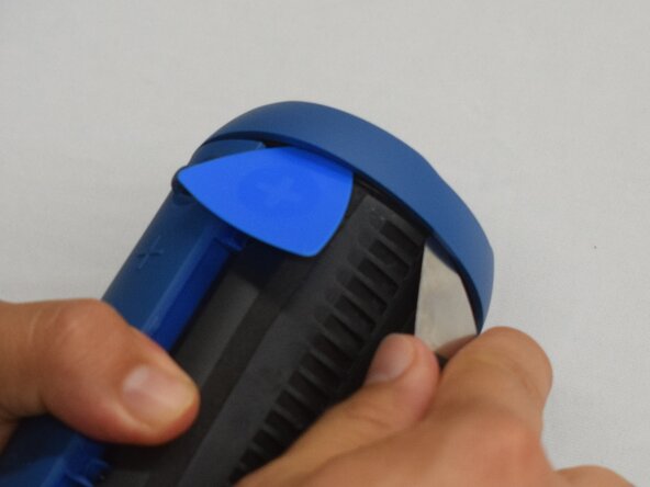

  4. Rienok S1 Mini Case Replacement, Top and Bottom Rings: crwdns2935265:04crwdnd2935265:01crwdnd2935265:02crwdne2935265:0 Rienok S1 Mini Case Replacement, Top and Bottom Rings: crwdns2935265:04crwdnd2935265:02crwdnd2935265:02crwdne2935265:0
    • Wedge an iFixit opening pick into the space between the ring and the housing.
    • Insert a Jimmy into the gap created.
    • Apply an out-and-upward pressure with the Jimmy to disconnect the plastic clips surrounding the ring.
    • Work the Jimmy around the ring, disconnecting the clips along the way until they are all disconnected.
    • It may help to insert additional opening picks as you go to keep the previous clips from reconnecting.

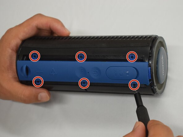

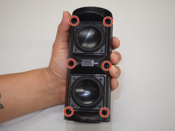

  6. Rienok S1 Mini Case Replacement, Buttons Panel: crwdns2935265:06crwdnd2935265:01crwdnd2935265:02crwdne2935265:0 Rienok S1 Mini Case Replacement, Buttons Panel: crwdns2935265:06crwdnd2935265:02crwdnd2935265:02crwdne2935265:0
    • Remove the six 8 mm black screws using a Phillips #000 screwdriver.

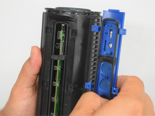

  7. Rienok S1 Mini Case Replacement: crwdns2935265:07crwdnd2935265:01crwdnd2935265:02crwdne2935265:0 Rienok S1 Mini Case Replacement: crwdns2935265:07crwdnd2935265:02crwdnd2935265:02crwdne2935265:0
    • With the screws removed, grasp the buttons panel and pull it off.

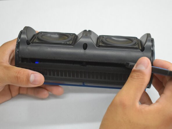

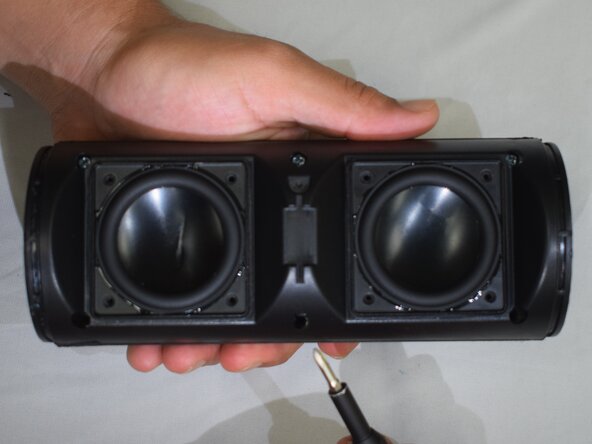

  8. Rienok S1 Mini Case Replacement, Case: crwdns2935265:08crwdnd2935265:01crwdnd2935265:03crwdne2935265:0 Rienok S1 Mini Case Replacement, Case: crwdns2935265:08crwdnd2935265:02crwdnd2935265:03crwdne2935265:0 Rienok S1 Mini Case Replacement, Case: crwdns2935265:08crwdnd2935265:03crwdnd2935265:03crwdne2935265:0
    • Hold the device with the speakers facing up.
    • Remove the six 10 mm silver screws connecting the two halves of the case with a Phillips #1 screwdriver.

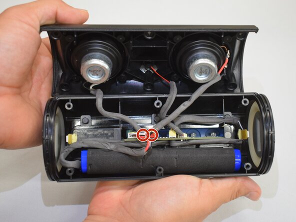

  9. Rienok S1 Mini Case Replacement: crwdns2935265:09crwdnd2935265:01crwdnd2935265:03crwdne2935265:0 Rienok S1 Mini Case Replacement: crwdns2935265:09crwdnd2935265:02crwdnd2935265:03crwdne2935265:0 Rienok S1 Mini Case Replacement: crwdns2935265:09crwdnd2935265:03crwdnd2935265:03crwdne2935265:0
    • Insert a Jimmy into the seam between both halves.
    • Lightly twist the Jimmy until a small gap appears.
    • Work the Jimmy across the length creating and widening the gap as you go across.
    • With the gap across the whole length, grasp both halves and lightly pull apart.
    • DO NOT yank apart; the two halves are still connected by a few cords.

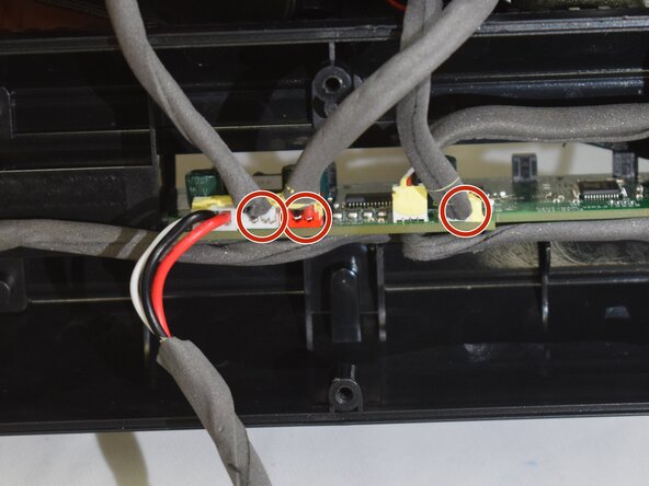

  10. Rienok S1 Mini Case Replacement: crwdns2935265:010crwdnd2935265:01crwdnd2935265:02crwdne2935265:0 Rienok S1 Mini Case Replacement: crwdns2935265:010crwdnd2935265:02crwdnd2935265:02crwdne2935265:0
    • Remove the foam glue from the plugs.
    • Grip the plugs with your fingernails, and gently pull each plug until all three are disconnected.
    • If replacing the case, pull on the battery and motherboard, and they will come right out.
