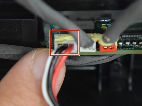

  10. Rienok S1 Mini Battery Replacement: crwdns2935265:010crwdnd2935265:01crwdnd2935265:02crwdne2935265:0 Rienok S1 Mini Battery Replacement: crwdns2935265:010crwdnd2935265:02crwdnd2935265:02crwdne2935265:0
    • Remove the foam glue from the plugs.
    • Grip the plugs with your fingernails, and gently pull each plug until all three are disconnected.
    • If replacing the case, pull on the battery and motherboard, and they will come right out.

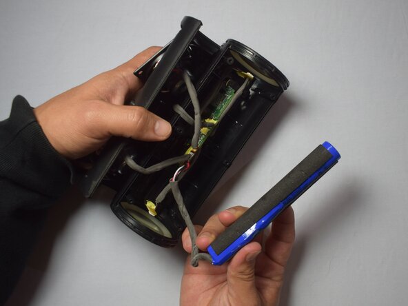

  11. Rienok S1 Mini Battery Replacement, Battery: crwdns2935265:011crwdnd2935265:01crwdnd2935265:03crwdne2935265:0 Rienok S1 Mini Battery Replacement, Battery: crwdns2935265:011crwdnd2935265:02crwdnd2935265:03crwdne2935265:0 Rienok S1 Mini Battery Replacement, Battery: crwdns2935265:011crwdnd2935265:03crwdnd2935265:03crwdne2935265:0
    • Gently grasp the battery and slowly and carefully remove it.
    • Remove the foam glue, and unplug the battery to disconnect it.
