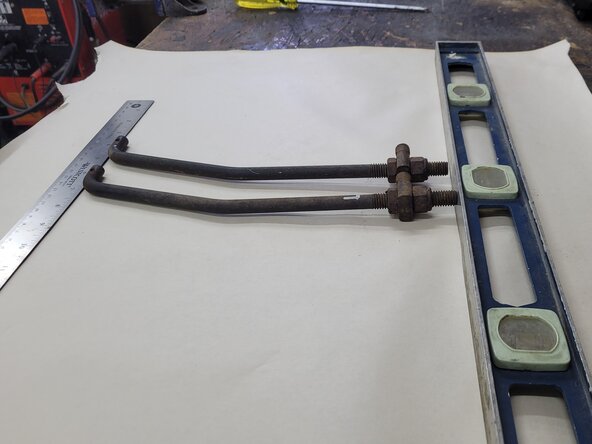

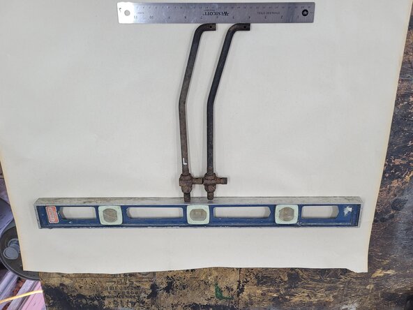

    • Really key to keeping the deck properly aligned is ensuring that the front links are not bent and that includes their mounting brackets
All instructions are covered in the You Tube video
