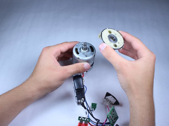

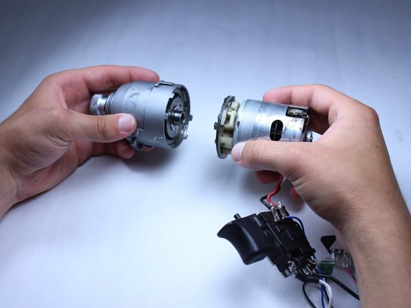

    1. Ridgid R86034 Motor Replacement, Motor: crwdns2935265:07crwdnd2935265:01crwdnd2935265:02crwdne2935265:0 Ridgid R86034 Motor Replacement, Motor: crwdns2935265:07crwdnd2935265:02crwdnd2935265:02crwdne2935265:0
      • Do not invert gear assembly! Keep gear assembly oriented so that the chuck is lower and the place the motor was attached is higher or else gears could fall out.
      • Twist off and separate the gear assembly from the motor assembly.
      • Some force will be required to twist off the gear assembly.
      • When putting the motor back onto the gear assembly, make sure that the tabs on the edge of the gear assembly are oriented to fit the tabs found on the edges of the motor.

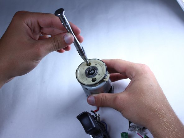

    2. Ridgid R86034 Motor Replacement: crwdns2935265:08crwdnd2935265:01crwdnd2935265:02crwdne2935265:0 Ridgid R86034 Motor Replacement: crwdns2935265:08crwdnd2935265:02crwdnd2935265:02crwdne2935265:0
      • Remove the two 14 mm long PH1 screws that connect the plastic object to the motor assembly.
    3. Ridgid R86034 Motor Replacement: crwdns2935265:09crwdnd2935265:01crwdnd2935265:02crwdne2935265:0 Ridgid R86034 Motor Replacement: crwdns2935265:09crwdnd2935265:02crwdnd2935265:02crwdne2935265:0
      • Remove the plastic object from the motor assembly.
      • It should not require that much force to remove the plastic object.

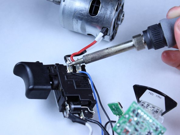

    4. Ridgid R86034 Motor Replacement: crwdns2935265:010crwdnd2935265:01crwdnd2935265:02crwdne2935265:0 Ridgid R86034 Motor Replacement: crwdns2935265:010crwdnd2935265:02crwdnd2935265:02crwdne2935265:0
      • Desolder and remove the red and black wires connecting the trigger assembly and the motor.
      • Take note of the orientation of the wires for when they need to be resoldered.
      • You should only desolder the top-left black wire and the top-right red wire, not the bottom-left black wire or the blue wire.
