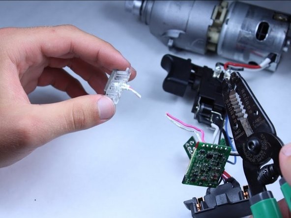

    1. Ridgid R86034 LED Replacement, LED: crwdns2935265:07crwdnd2935265:01crwdnd2935265:01crwdne2935265:0
      • Identify the LED light. The LED light is the component with clear casing and has two wires attached, located toward the bottom of the driver.
    2. Ridgid R86034 LED Replacement: crwdns2935265:08crwdnd2935265:01crwdnd2935265:03crwdne2935265:0 Ridgid R86034 LED Replacement: crwdns2935265:08crwdnd2935265:02crwdnd2935265:03crwdne2935265:0 Ridgid R86034 LED Replacement: crwdns2935265:08crwdnd2935265:03crwdnd2935265:03crwdne2935265:0

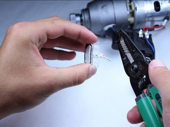

      • Cut the pink and white wires attached to the LED at a point that is a little more than 1/4 inch from the LED.
    3. Ridgid R86034 LED Replacement: crwdns2935265:09crwdnd2935265:01crwdnd2935265:01crwdne2935265:0
      • Strip the wires back about 1/4 inch on the LED.

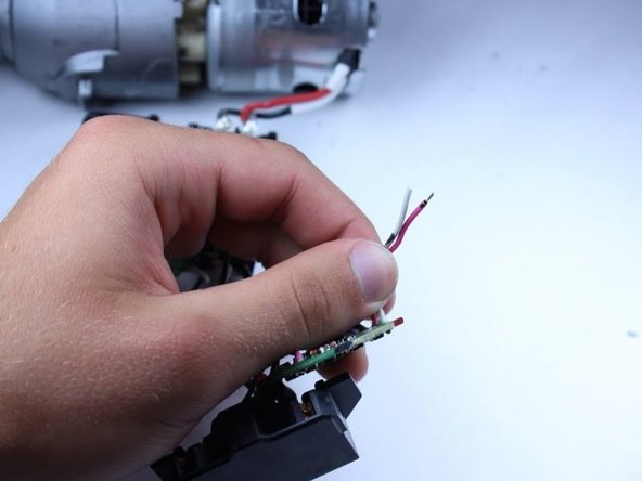

    4. Ridgid R86034 LED Replacement: crwdns2935265:010crwdnd2935265:01crwdnd2935265:02crwdne2935265:0 Ridgid R86034 LED Replacement: crwdns2935265:010crwdnd2935265:02crwdnd2935265:02crwdne2935265:0
      • Strip the wires that were connected to the LED on the circuit board to approximately 1/4 inch.
    5. Ridgid R86034 LED Replacement: crwdns2935265:011crwdnd2935265:01crwdnd2935265:01crwdne2935265:0
      • Solder the new LED striped wires to the wire attached to the circuit board.
      • Wrap the soldered connection with electrical tape, to ensure that the circuit isn't shorted.
