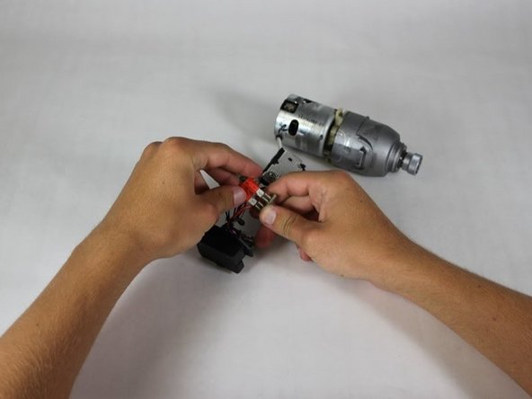

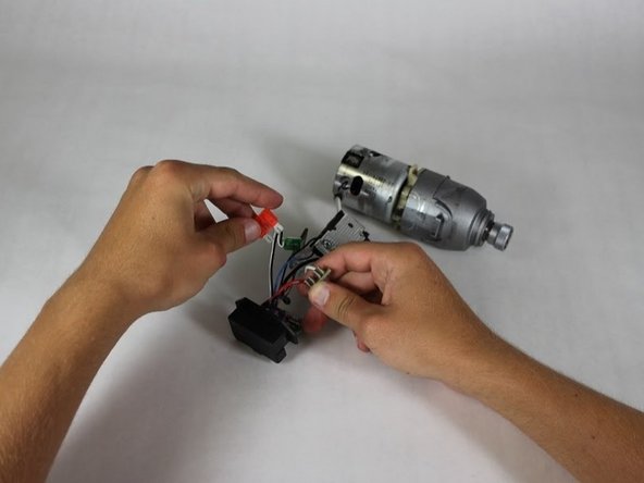

  7. Ridgid R86034 Fuse Cartridge Replacement, Fuse Cartridge: crwdns2935265:07crwdnd2935265:01crwdnd2935265:01crwdne2935265:0
    • Identify the translucent orange fuse cartridge connected by a thick red wire and a thick white wire.
  8. Ridgid R86034 Fuse Cartridge Replacement: crwdns2935265:08crwdnd2935265:01crwdnd2935265:03crwdne2935265:0 Ridgid R86034 Fuse Cartridge Replacement: crwdns2935265:08crwdnd2935265:02crwdnd2935265:03crwdne2935265:0 Ridgid R86034 Fuse Cartridge Replacement: crwdns2935265:08crwdnd2935265:03crwdnd2935265:03crwdne2935265:0
    • Firmly grasp the orange fuse cartridge and pull it out of its socket.
    • The fuse does not come out easily. You will need to use some force to get it out.
  9. Ridgid R86034 Fuse Cartridge Replacement: crwdns2935265:09crwdnd2935265:01crwdnd2935265:03crwdne2935265:0 Ridgid R86034 Fuse Cartridge Replacement: crwdns2935265:09crwdnd2935265:02crwdnd2935265:03crwdne2935265:0 Ridgid R86034 Fuse Cartridge Replacement: crwdns2935265:09crwdnd2935265:03crwdnd2935265:03crwdne2935265:0
    • Insert the new fuse cartridge.
