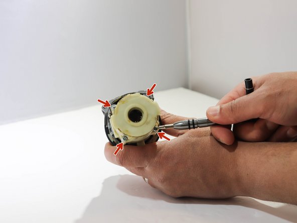

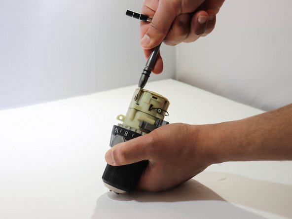

  5. Ridgid R86008 Gearbox Replacement: crwdns2935265:05crwdnd2935265:01crwdnd2935265:03crwdne2935265:0 Ridgid R86008 Gearbox Replacement: crwdns2935265:05crwdnd2935265:02crwdnd2935265:03crwdne2935265:0 Ridgid R86008 Gearbox Replacement: crwdns2935265:05crwdnd2935265:03crwdnd2935265:03crwdne2935265:0
    • Using a PH1 screwdriver, remove the four 13mm PH screws from the back of the gearbox.
    • It may be easier to unscrew the screws by separating the front end of the drill from the rest of the drill.
  6. Ridgid R86008 Gearbox Replacement: crwdns2935265:06crwdnd2935265:01crwdnd2935265:01crwdne2935265:0
    • Pull apart gearbox.
