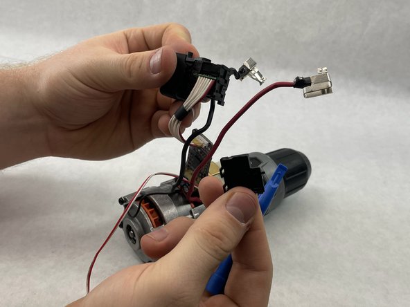

  4. Ridgid R860054 Trigger Replacement: crwdns2935265:04crwdnd2935265:01crwdnd2935265:01crwdne2935265:0
    • The main section of the drill should have the trigger, light indicator, and battery prongs all connected via wire. There should be two plastic switches separated from the rest of the body.

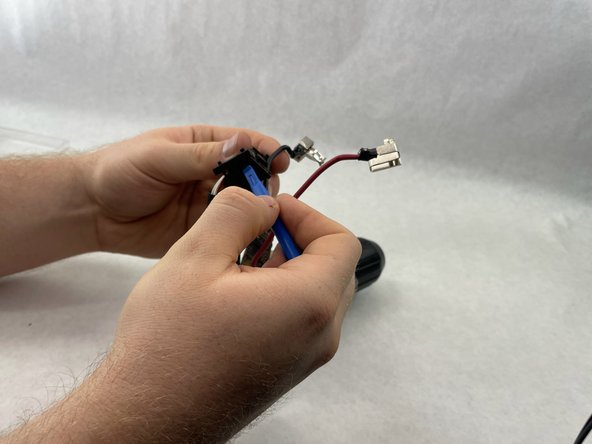

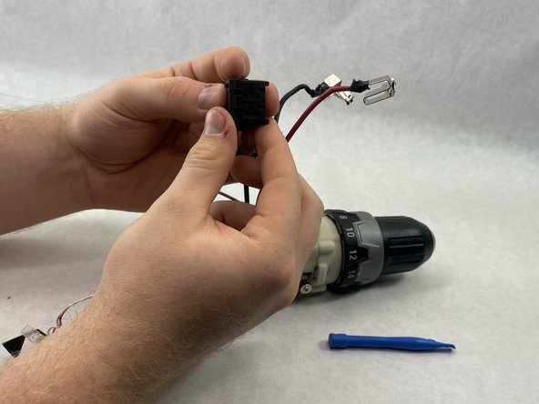

  5. Ridgid R860054 Trigger Replacement, Trigger: crwdns2935265:05crwdnd2935265:01crwdnd2935265:03crwdne2935265:0 Ridgid R860054 Trigger Replacement, Trigger: crwdns2935265:05crwdnd2935265:02crwdnd2935265:03crwdne2935265:0 Ridgid R860054 Trigger Replacement, Trigger: crwdns2935265:05crwdnd2935265:03crwdnd2935265:03crwdne2935265:0
    • Use a thin tool to disconnect the three prongs.
    • Remove the black plastic piece from the trigger body.
    • On the new trigger, follow the same steps as above and remove the cap.

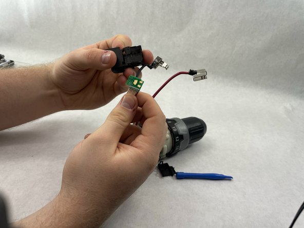

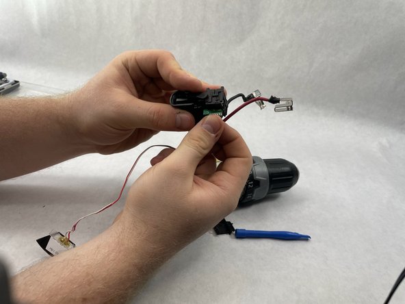

  6. Ridgid R860054 Trigger Replacement: crwdns2935265:06crwdnd2935265:01crwdnd2935265:02crwdne2935265:0 Ridgid R860054 Trigger Replacement: crwdns2935265:06crwdnd2935265:02crwdnd2935265:02crwdne2935265:0
    • Remove the trigger circuit from the plastic trigger body.
  7. Ridgid R860054 Trigger Replacement: crwdns2935265:07crwdnd2935265:01crwdnd2935265:03crwdne2935265:0 Ridgid R860054 Trigger Replacement: crwdns2935265:07crwdnd2935265:02crwdnd2935265:03crwdne2935265:0 Ridgid R860054 Trigger Replacement: crwdns2935265:07crwdnd2935265:03crwdnd2935265:03crwdne2935265:0
    • Place the circuit into the new trigger and closure.
    • Place the plastic cap back on the trigger to secure the wire.
