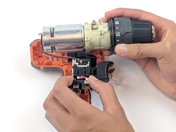

  3. Ridgid R82005 Trigger Switch Replacement: crwdns2935265:03crwdnd2935265:01crwdnd2935265:03crwdne2935265:0 Ridgid R82005 Trigger Switch Replacement: crwdns2935265:03crwdnd2935265:02crwdnd2935265:03crwdne2935265:0 Ridgid R82005 Trigger Switch Replacement: crwdns2935265:03crwdnd2935265:03crwdnd2935265:03crwdne2935265:0
    • Remove the top half of the Housing Assembly.
    • Keep track of where the wires lead from the motor assembly to trigger switch.
    • Remove all internal components.

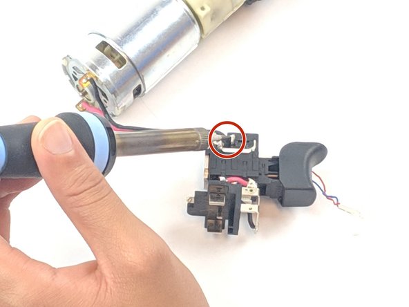

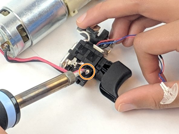

  4. Ridgid R82005 Trigger Switch Replacement: crwdns2935265:04crwdnd2935265:01crwdnd2935265:03crwdne2935265:0 Ridgid R82005 Trigger Switch Replacement: crwdns2935265:04crwdnd2935265:02crwdnd2935265:03crwdne2935265:0 Ridgid R82005 Trigger Switch Replacement: crwdns2935265:04crwdnd2935265:03crwdnd2935265:03crwdne2935265:0
    • Motor Assembly/Gearbox and Trigger Switch removed from Housing Assembly.
    • Desolder the black wire connected to the motor.
    • Flip Trigger Switch and desolder red wire.
    • To learn how to solder, use our How to Solder and Desolder Connections guide.
