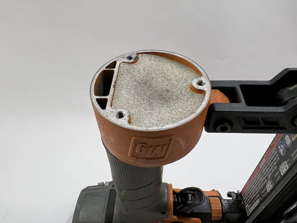

Ridgid R250SFF Bottom O-Ring and Gasket Replacement
  1. Ridgid R250SFF Bottom O-Ring and Gasket Replacement, Bottom O-Ring and Gasket: crwdns2935265:01crwdnd2935265:01crwdnd2935265:02crwdne2935265:0 Ridgid R250SFF Bottom O-Ring and Gasket Replacement, Bottom O-Ring and Gasket: crwdns2935265:01crwdnd2935265:02crwdnd2935265:02crwdne2935265:0
    • Positioning the nailer so the air plug is facing towards you, use a 3-Gauge Allen wrench to remove the three screws.
  2. Ridgid R250SFF Bottom O-Ring and Gasket Replacement: crwdns2935265:02crwdnd2935265:01crwdnd2935265:03crwdne2935265:0 Ridgid R250SFF Bottom O-Ring and Gasket Replacement: crwdns2935265:02crwdnd2935265:02crwdnd2935265:03crwdne2935265:0 Ridgid R250SFF Bottom O-Ring and Gasket Replacement: crwdns2935265:02crwdnd2935265:03crwdnd2935265:03crwdne2935265:0
    • Removing the both the air plug and the belt hook, you should see the gasket resting on the air filter.
  3. Ridgid R250SFF Bottom O-Ring and Gasket Replacement: crwdns2935265:03crwdnd2935265:01crwdnd2935265:02crwdne2935265:0 Ridgid R250SFF Bottom O-Ring and Gasket Replacement: crwdns2935265:03crwdnd2935265:02crwdnd2935265:02crwdne2935265:0
    • Around the base of this will be the O-Ring. Replace the worn O-Ring along with the worn Gasket.
    • The example model provided to our team lacks an O-Ring.
