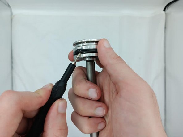

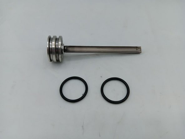

  3. Ridgid R175RNE Driving Blade O-Rings Replacement: crwdns2935265:03crwdnd2935265:01crwdnd2935265:03crwdne2935265:0 Ridgid R175RNE Driving Blade O-Rings Replacement: crwdns2935265:03crwdnd2935265:02crwdnd2935265:03crwdne2935265:0 Ridgid R175RNE Driving Blade O-Rings Replacement: crwdns2935265:03crwdnd2935265:03crwdnd2935265:03crwdne2935265:0
    • Remove the piston assembly.
    • Remove both O-rings with either a spudger.
