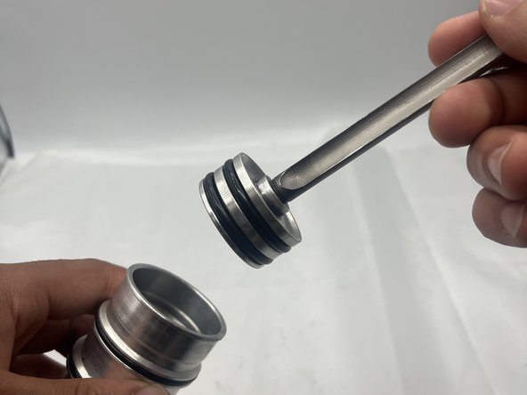

  2. Ridgid R175RNE Driver Blade Replacement, Driver Blade: crwdns2935265:02crwdnd2935265:01crwdnd2935265:03crwdne2935265:0 Ridgid R175RNE Driver Blade Replacement, Driver Blade: crwdns2935265:02crwdnd2935265:02crwdnd2935265:03crwdne2935265:0 Ridgid R175RNE Driver Blade Replacement, Driver Blade: crwdns2935265:02crwdnd2935265:03crwdnd2935265:03crwdne2935265:0
    • Disconnect the nailer from the air compressor before beginning.
    • Pull the back portion of the nailer out from the main body.
    • You will be left with the driving cylinder body, with the blade within.
    • Take note of which way the plastic collar on the cylinder is placed, for reassembly.

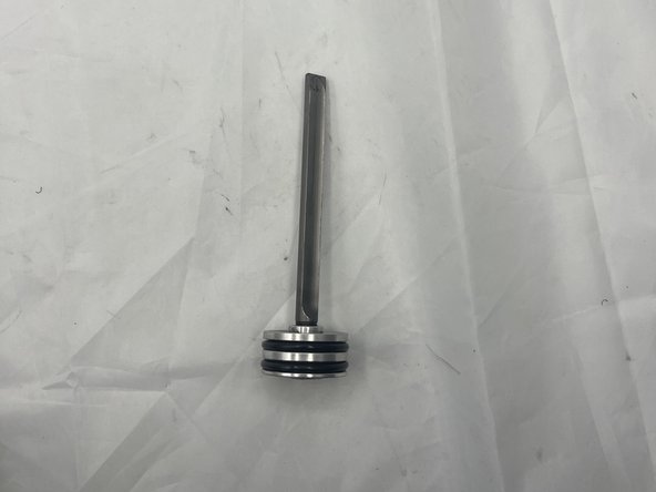

  3. Ridgid R175RNE Driver Blade Replacement: crwdns2935265:03crwdnd2935265:01crwdnd2935265:03crwdne2935265:0 Ridgid R175RNE Driver Blade Replacement: crwdns2935265:03crwdnd2935265:02crwdnd2935265:03crwdne2935265:0 Ridgid R175RNE Driver Blade Replacement: crwdns2935265:03crwdnd2935265:03crwdnd2935265:03crwdne2935265:0
    • Flip the cylinder body around to the side that has the driving blade sticking out.
    • Pull the driving blade out from the cylinder.
Once you have replaced your driving blade, reassemble your device by following these instructions in reverse order.
