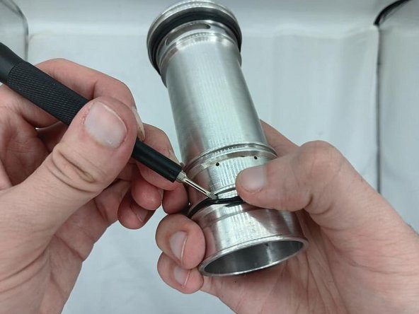

  2. Ridgid R175RNE Cylinder O-Rings Replacement, Driver Cylinder O-Rings: crwdns2935265:02crwdnd2935265:01crwdnd2935265:03crwdne2935265:0 Ridgid R175RNE Cylinder O-Rings Replacement, Driver Cylinder O-Rings: crwdns2935265:02crwdnd2935265:02crwdnd2935265:03crwdne2935265:0 Ridgid R175RNE Cylinder O-Rings Replacement, Driver Cylinder O-Rings: crwdns2935265:02crwdnd2935265:03crwdnd2935265:03crwdne2935265:0
    • Disconnect the nailer from the air compressor before beginning.
    • Remove the driver cylinder and place the nailer body to the side.
    • Take note of the orientation the plastic ring is on the cylinder.

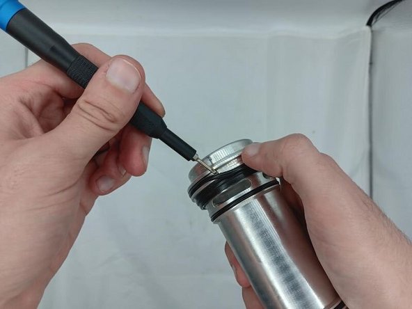

  3. Ridgid R175RNE Cylinder O-Rings Replacement: crwdns2935265:03crwdnd2935265:01crwdnd2935265:03crwdne2935265:0 Ridgid R175RNE Cylinder O-Rings Replacement: crwdns2935265:03crwdnd2935265:02crwdnd2935265:03crwdne2935265:0 Ridgid R175RNE Cylinder O-Rings Replacement: crwdns2935265:03crwdnd2935265:03crwdnd2935265:03crwdne2935265:0
    • Take your o-ring pick or flathead and gently slide the tip under the O-ring.
    • Stretch it only as far as to remove it from its indentation.
    • Repeat with other four O-rings starting, from top to bottom.
    • There should be 5 O-rings in total.
