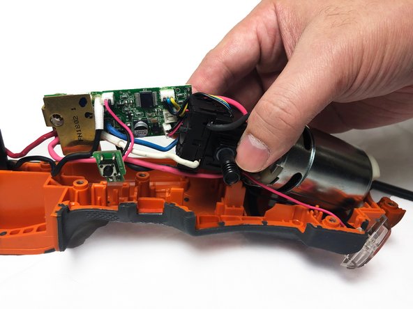

    • Carefully remove the motor as well as the main board from the drill cover.

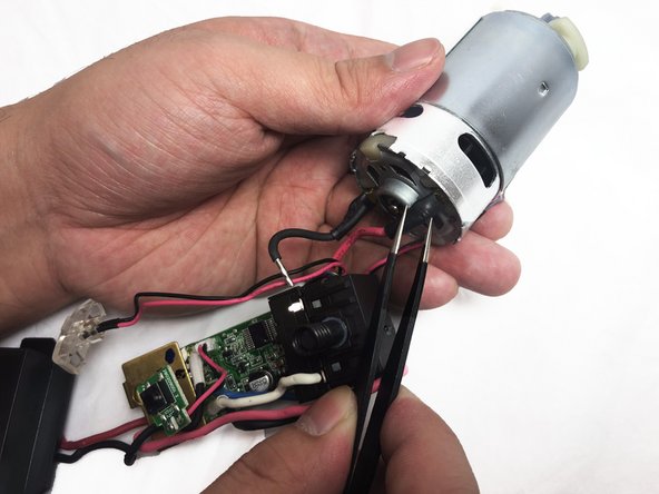

    • Find the black and red wires from the motor.
    • Remove the electrical tape using tweezers.
    • Using a soldering iron, desolder the black and red wires from the motor.
    • Refer to this helpful guide for tips on soldering/desoldering.
