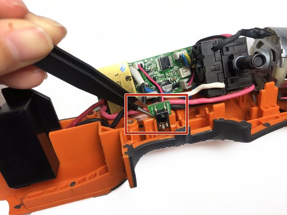

    • Locate the LED grip light switch at the waist of the device.
  3. Ridgid JobMax R8620 Series E LED Grip Light Switch Replacement: crwdns2935265:03crwdnd2935265:01crwdnd2935265:02crwdne2935265:0 Ridgid JobMax R8620 Series E LED Grip Light Switch Replacement: crwdns2935265:03crwdnd2935265:02crwdnd2935265:02crwdne2935265:0

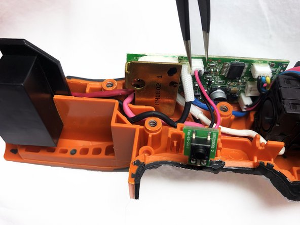

    • Remove the plastic switch with the spring from the groove of the housing by hand.
    • Check to see if there are problems with the plastic switch or the spring.
  4. Ridgid JobMax R8620 Series E LED Grip Light Switch Replacement: crwdns2935265:04crwdnd2935265:01crwdnd2935265:02crwdne2935265:0 Ridgid JobMax R8620 Series E LED Grip Light Switch Replacement: crwdns2935265:04crwdnd2935265:02crwdnd2935265:02crwdne2935265:0
    • Find the slot on the motherboard along the wiring of the device.
    • Use tweezers to pull the plug out of the host slot.
