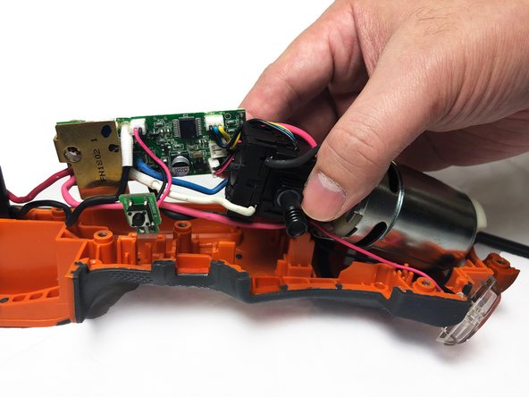

    • Using a spudger or your fingers, remove the LED light from the groove in the handle.
  3. Ridgid JobMax R8620 Series E LED Grip Light Replacement: crwdns2935265:03crwdnd2935265:01crwdnd2935265:02crwdne2935265:0 Ridgid JobMax R8620 Series E LED Grip Light Replacement: crwdns2935265:03crwdnd2935265:02crwdnd2935265:02crwdne2935265:0

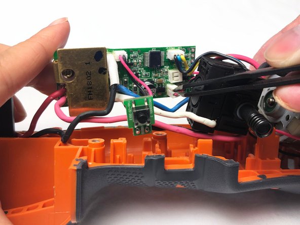

    • Carefully remove the motor as well as the main board from the drill cover.
  4. Ridgid JobMax R8620 Series E LED Grip Light Replacement: crwdns2935265:04crwdnd2935265:01crwdnd2935265:02crwdne2935265:0 Ridgid JobMax R8620 Series E LED Grip Light Replacement: crwdns2935265:04crwdnd2935265:02crwdnd2935265:02crwdne2935265:0
    • Find the corresponding position of the LED line on the motherboard. If necessary, use tweezers to pull it out and replace it.
