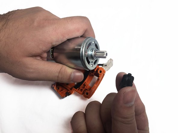

  2. Ridgid JobMax R8620 Series E Drive Gear Cover Replacement: crwdns2935265:02crwdnd2935265:01crwdnd2935265:01crwdne2935265:0
    • After opening the cover, find the motor and pry it apart from the case in order to have space to do the replacement.

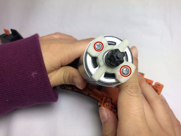

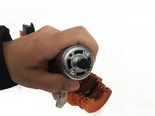

    • Find the gear cover.
    • Using a Phillips #0 screwdriver, remove the two screws on the plastic protective plate.
    • Remove the plastic plate.
  4. Ridgid JobMax R8620 Series E Drive Gear Cover Replacement: crwdns2935265:04crwdnd2935265:01crwdnd2935265:02crwdne2935265:0 Ridgid JobMax R8620 Series E Drive Gear Cover Replacement: crwdns2935265:04crwdnd2935265:02crwdnd2935265:02crwdne2935265:0
    • Carefully pull off the gear cover.
