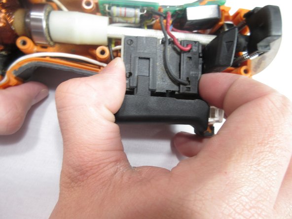

  6. Ridgid JobMax R2851 Series B Cord Replacement: crwdns2935265:06crwdnd2935265:01crwdnd2935265:02crwdne2935265:0 Ridgid JobMax R2851 Series B Cord Replacement: crwdns2935265:06crwdnd2935265:02crwdnd2935265:02crwdne2935265:0
    • Grip each of the sides of the two green circuit boards and slide them up.
    • Grip each side of the device trigger, and slide it up.
    • You do not need to completely remove these parts. Sliding them upward provides the needed room.

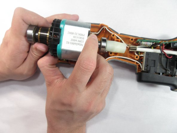

  7. Ridgid JobMax R2851 Series B Cord Replacement: crwdns2935265:07crwdnd2935265:01crwdnd2935265:02crwdne2935265:0 Ridgid JobMax R2851 Series B Cord Replacement: crwdns2935265:07crwdnd2935265:02crwdnd2935265:02crwdne2935265:0

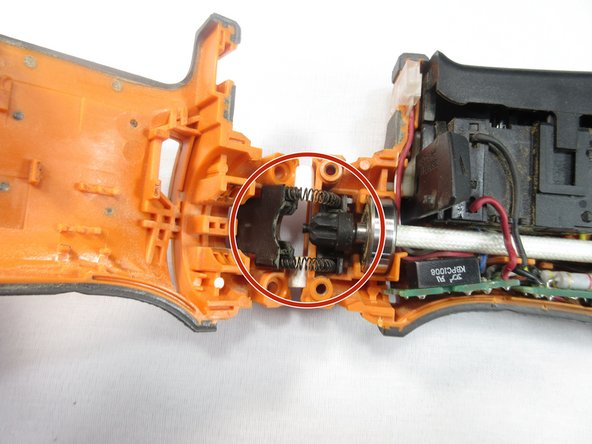

    • Grip the motor firmly and pull towards the back of the tool, rotating back forth until the motor is free.
    • When reinstalling the motor, use a spudger to pull back the brushes. This allows the motor to slide into place.

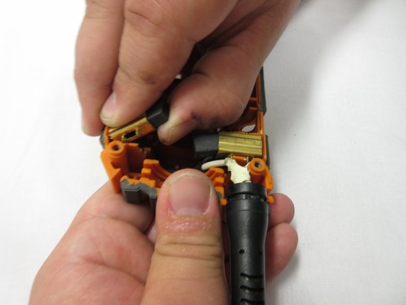

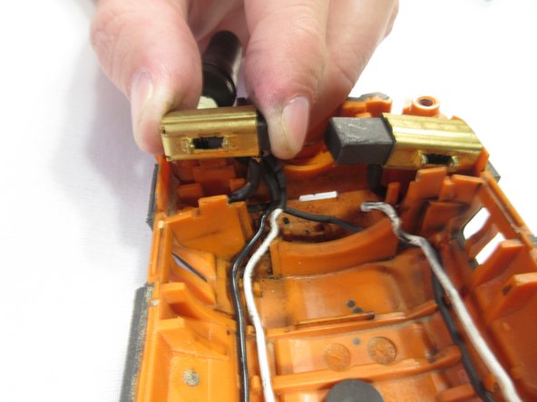

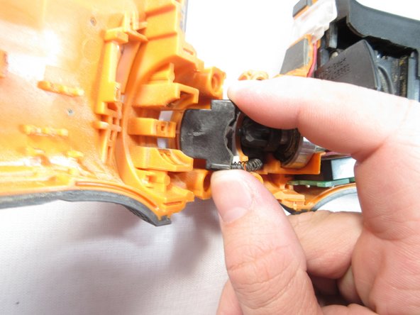

  8. Ridgid JobMax R2851 Series B Cord Replacement, Motor Brushes: crwdns2935265:08crwdnd2935265:01crwdnd2935265:03crwdne2935265:0 Ridgid JobMax R2851 Series B Cord Replacement, Motor Brushes: crwdns2935265:08crwdnd2935265:02crwdnd2935265:03crwdne2935265:0 Ridgid JobMax R2851 Series B Cord Replacement, Motor Brushes: crwdns2935265:08crwdnd2935265:03crwdnd2935265:03crwdne2935265:0
    • Pinch the brush and pry upward away from the center of the part to remove from the device.
    • Take care to not damage the connections on the bottom of the brush.

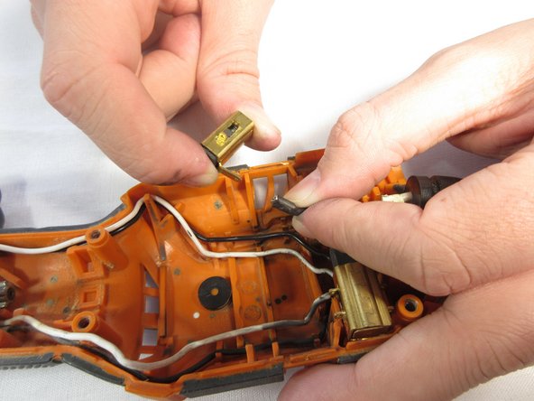

  9. Ridgid JobMax R2851 Series B Cord Replacement: crwdns2935265:09crwdnd2935265:01crwdnd2935265:02crwdne2935265:0 Ridgid JobMax R2851 Series B Cord Replacement: crwdns2935265:09crwdnd2935265:02crwdnd2935265:02crwdne2935265:0
    • Firmly hold the brush in one hand and pull at the base of the wire to disconnect.
