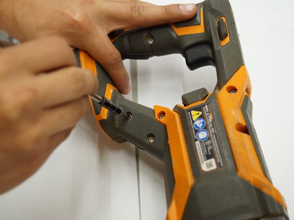

    • Use a T20 Torx screwdriver to remove the nine M4 X 16mm screws from the plastic housing.
