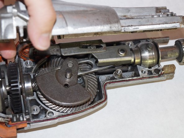

  7. Ridgid GEN5X R8642 Gear Assembly Replacement: crwdns2935265:07crwdnd2935265:01crwdnd2935265:03crwdne2935265:0 Ridgid GEN5X R8642 Gear Assembly Replacement: crwdns2935265:07crwdnd2935265:02crwdnd2935265:03crwdne2935265:0 Ridgid GEN5X R8642 Gear Assembly Replacement: crwdns2935265:07crwdnd2935265:03crwdnd2935265:03crwdne2935265:0
    • Remove the five T20 Torx screws from the gear assembly cover and pull the cover off.

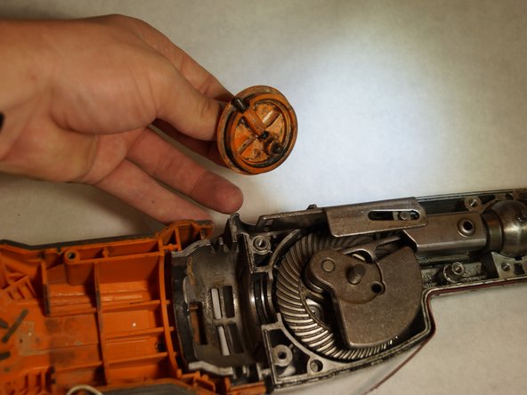

    • Remove the orbital switch by pulling straight up on it.
    • Be careful to not lose the spring and pin that is inside of the switch.

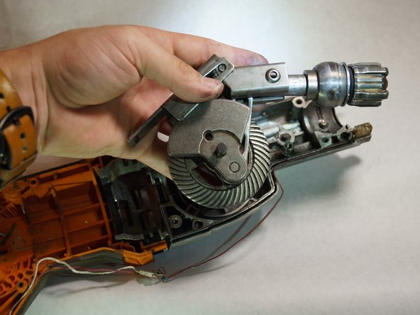

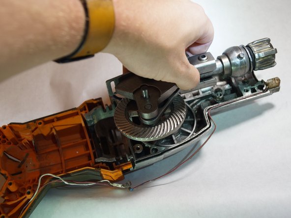

    • Remove the gear assembly by pulling it straight up.
  11. Ridgid GEN5X R8642 Gear Assembly Replacement: crwdns2935265:011crwdnd2935265:01crwdnd2935265:03crwdne2935265:0 Ridgid GEN5X R8642 Gear Assembly Replacement: crwdns2935265:011crwdnd2935265:02crwdnd2935265:03crwdne2935265:0 Ridgid GEN5X R8642 Gear Assembly Replacement: crwdns2935265:011crwdnd2935265:03crwdnd2935265:03crwdne2935265:0

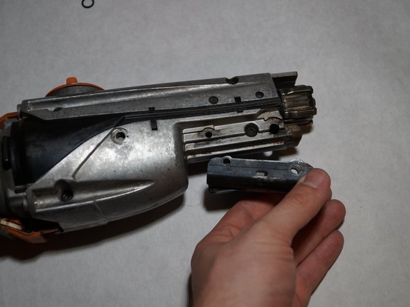

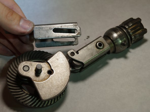

    • Pull the pin holding the metal guide housing in place.
    • Slide the metal guide housing back off the gear assembly.
  12. Ridgid GEN5X R8642 Gear Assembly Replacement: crwdns2935265:012crwdnd2935265:01crwdnd2935265:02crwdne2935265:0 Ridgid GEN5X R8642 Gear Assembly Replacement: crwdns2935265:012crwdnd2935265:02crwdnd2935265:02crwdne2935265:0

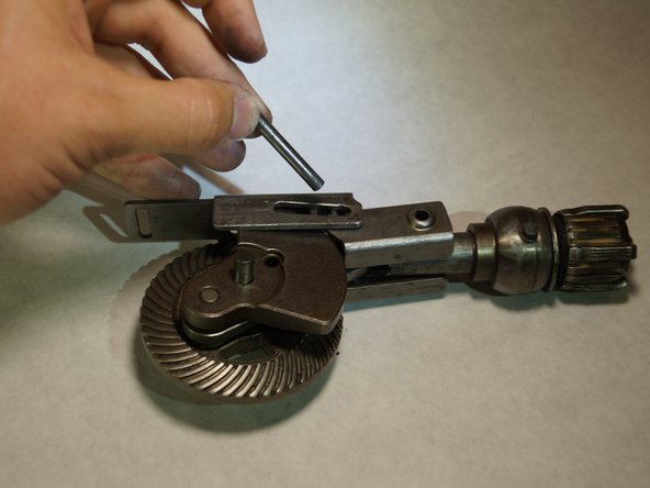

    • Remove the guide bushing by pulling up on it.

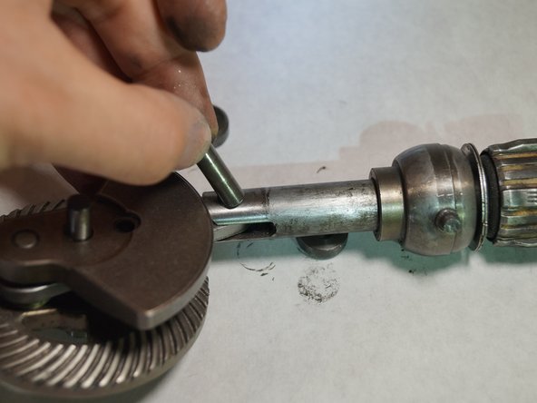

    • Then slide the pin out that holds the gear assembly and blade clamp assembly.
  13. Ridgid GEN5X R8642 Gear Assembly Replacement: crwdns2935265:013crwdnd2935265:01crwdnd2935265:01crwdne2935265:0
    • Slide the blade clamp assembly off the gear assembly.
